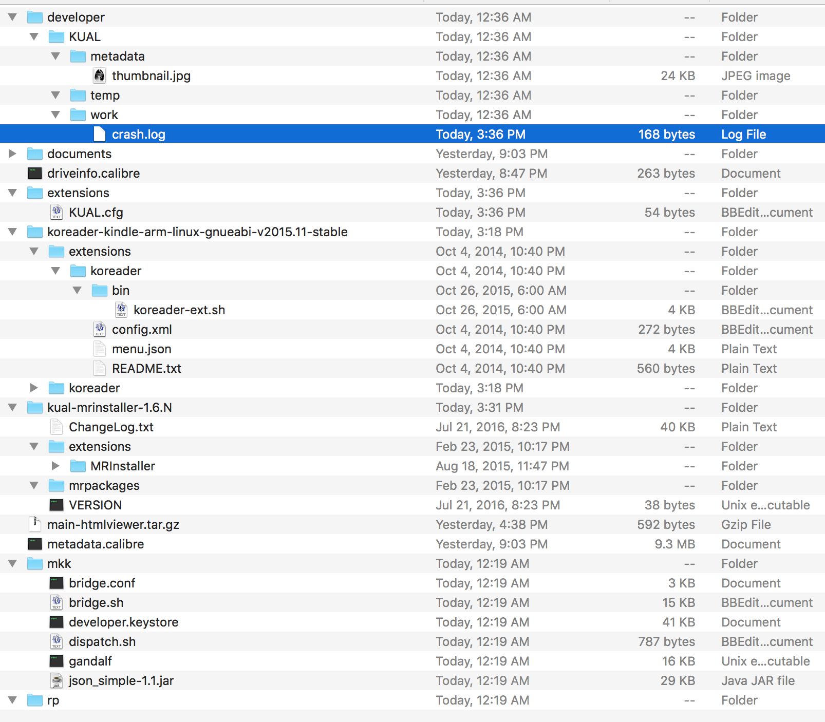

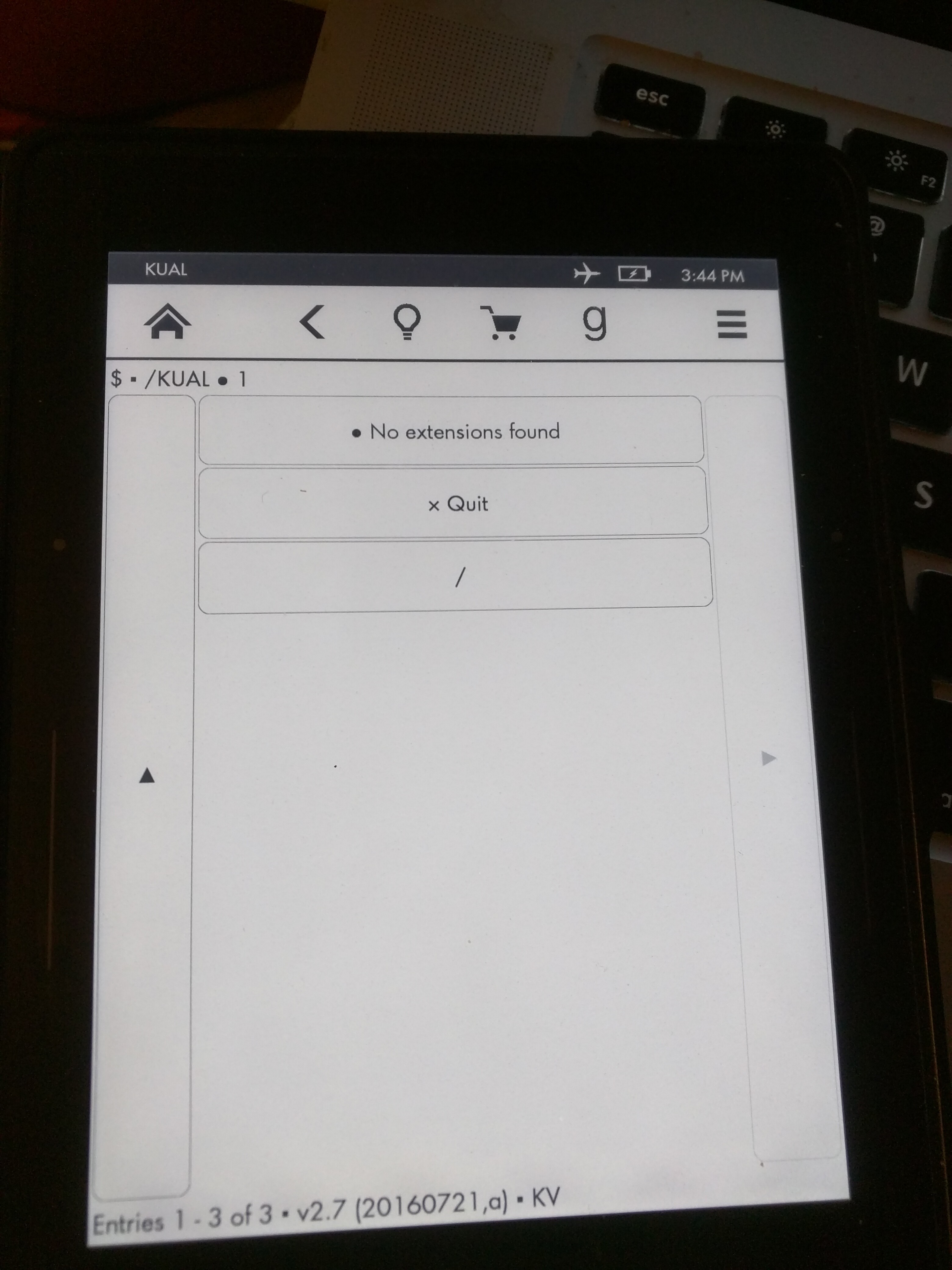

I have a KV with firmware 5.6.1.0.5
I believe I have successfully Jailbroke and installed KUAL, but cannot seem to install any utilities.
Here is a screenshot of my Kindle USB directory as seen from my Mac. And a screenshot of KUAL when I launch it.
I expect my directory structure is wrong, but would appreciate any help. I have googled and read a lot of the forums but could not find the answer so sorry if this is a really stupid question.
Thanks

You must have an "extensions" folder at the same level of the "document" folder.
Inside the "extensions" folder, put one folder for each extension you want:
-document
-extensions
--kterm
--skipstone
--koreader
-koreader
NB: koreader needs a koreader folder into the extensions and one koreader folder at the same level of documents (as in the zip)

HarryT, Thanks for moving my post. My instinct was to put it in developer, but I hate to bother developers.
encol, your instructions were perfect. I downloaded the zips, moved them into the root of the Kindle, then unzipped them by double clicking. I think the problem was that it created a new subdirectory first. Anyway, if there is not a post showing what the directory structure should look like when a few extensions are added, it would be nice for someone more expert than I to create one.

With the only exception that I can think of being kTerm and maybe KOreader, any of the archived KUAL extensions are packed so that they only have to be un-archived in the topmost, visible, level of the USB storage.
Each will create an extensions/<add-in name> sub-tree.
It does not need a diagram, only reading and following directions.
Any of our add-ins that are packaged in an update_*.bin name format must be installed using MrPI - -
Re-read Step #8 of the current jail break.
Those packages all have scripting that will do the thinking for you.
That horrid mess you made a screenshot of is because you have your MAC OSx archive handler in "stupid" mode - so that it first creates a directory named the same as the source archive.
You should have an option to disable that overly helpful "feature".
Disable that feature of your archiver -
Delete that mess you added -
The just place the Contents of the archive in the top level of visible USB storage.
No diagrams needed, just set the archiver so that it does not precede the content's directory structure with a directory named after the archive.
