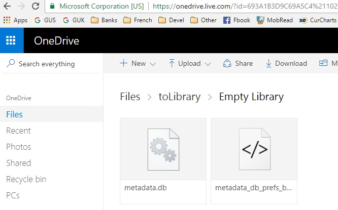

CC recognizes a calibre library by the presence of the calibre file "metadata.db". If that file isn't there then that folder is not a library.
The attached image shows the contents of a folder manager that contains an empty calibre library using the web-based Onedrive file.
Verify that the calibre file actually exists in the folder you think is the library. If it does then we have more work to do.

Thanks for the reply. My Onedrive Calibre Library folder contains 2 files (metadata.db and metadata_db_prefs_backup.json) as well as the folders containing the epub files etc.
