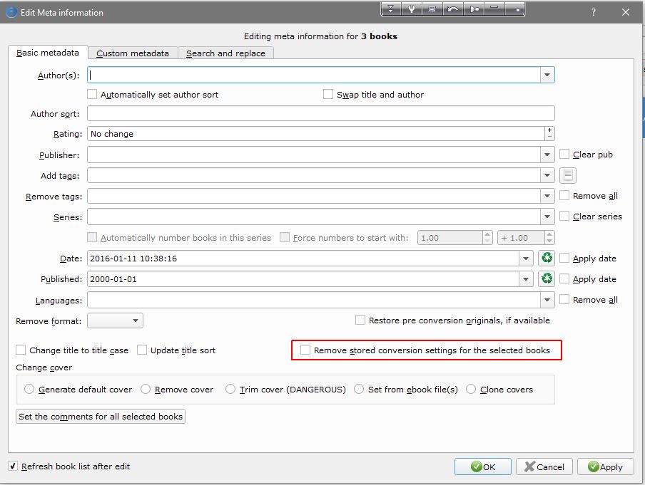

Do you realise that when you convert a book the settings used are saved and will be used by default for future conversions of that book? If you want the current system defaults to be used then you have to explicitly tell Calibre not to used the saved settings. It seems this might be what you are experiencing?
Old 01-10-2016, 07:44 PM   #3
Posts: 22,033
Karma: 30277294
- see ==>> How options are set/saved for Conversion
You can remove book specific conversion settings, thus reverting to defaults you have in preferences, in bulk metadata edit, viz:
Select all your books via Ctrl+A with no active VL or search, tick the box, click Apply - should only take moments because the settings are in the database.
Attachment 145416

Correct - if you set book specific conversion settings they are stored in the database (conversion_options), those settings will be used for future conversions of that book, until you change (overwrite) them, or discard them via reset to defaults for the individual book or in bulk for all selected books.
Pity there's not an option in the Quality Check PI to list books that have book specific conversion settings.
