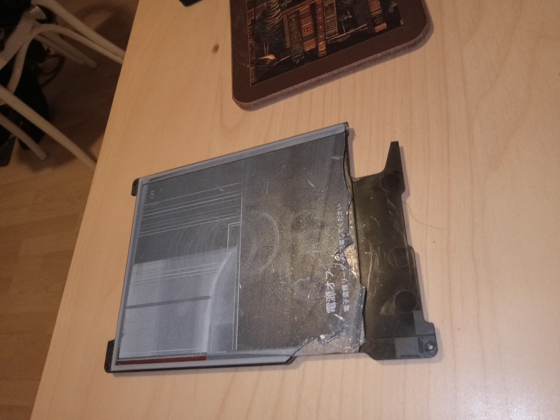

Question How do i separate this e-ink screen from the frame? [ Kobo aura edition 2 ]
See attachment
Thanks you.

Hi,
I have had trouble with the glue on my Aura HD... a hint found later on youtube was to slightly warm the border, to melt the glue, without melting the device obviously!
Not sure how to achieve that, probably a hair dryer, maybe applied at the back to avoid damaging the eink system...
Regards

To apply heat to adhesives for these kinda mobile device teardowns and repairs, we professionals use heat guns. They are relatively inexpensive tools found at virtually any hardware store.
You would use the heat gun on a lower setting if you need to be careful. You always wave the gun back and forth to avoid concentrating the heat in one spot. Apply heat, peel adhesive, apply again, peel some more, apply again, peel some more, until finally it starts to give. When meeting resistance, warm it up again.
If you've never done mobile device repairs before, be prepared to break things and accept your mistakes. It WILL happen.

You should look to see what replacement parts are even available. That looks like a full lcd assembly you're splitting apart. You probably don't need to. If a replacement is available, it ought to be the whole assembly.
