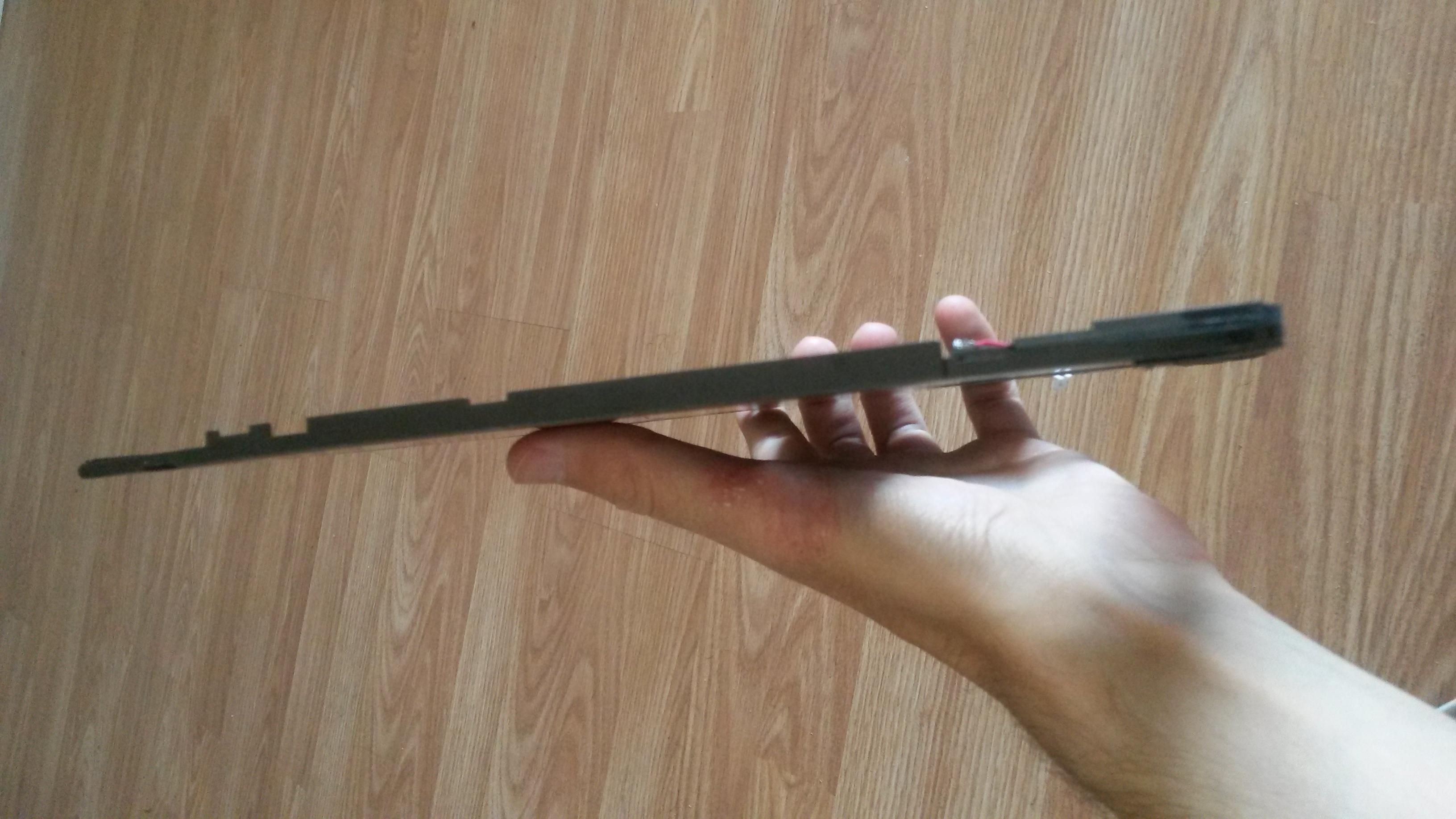

So please welcome my iDXG... The lighter DXG which will see different hardware/software modifications as we go.
I removed the mid-frame now and my DXG is extremely light to my hand now. I don't have a scale to weigh it, but when I have both my K3 and DXG in hands they weigh quite similarly.
This is at the cost of not having speakers in my DXG (for now) though. Very happy.
Update:
- The internals is a beauty. Simple and very spacious. Oh my Goodness, there are so many things one can do I believe.
- Given the battery is only 1530mAh, fairly small, If/when the battery dies, one can even put a modified yet bigger battery (somehow with some hardware magic). But boy oh boy, that mid-frame is so thick and unnecessarily heavy!!!
- If anyone can think of any reason (security etc.) why removing the mid-frame is bad for the health of the device, please let me know.

So those 7 prongs are for grounding connected to the backplate? Oh, I put a piece of paper behind the backplate, as a precautionary measure not to touch the internals and motherboard's juicy electronic stuff (including those J15-J21 )
But, TBH, I highly recommend removing the mid-frame for every DX owner, it makes lots of difference in terms of weight. I don't know why Amazon (Lab126) jammed this thick mid-frame in there (picture attached). I can now effortlessly pick up and hold just with 1 hand.
Damn, some pedant people even would be happy even with 18 screws less meat (well, metal in this case) on this baby!
