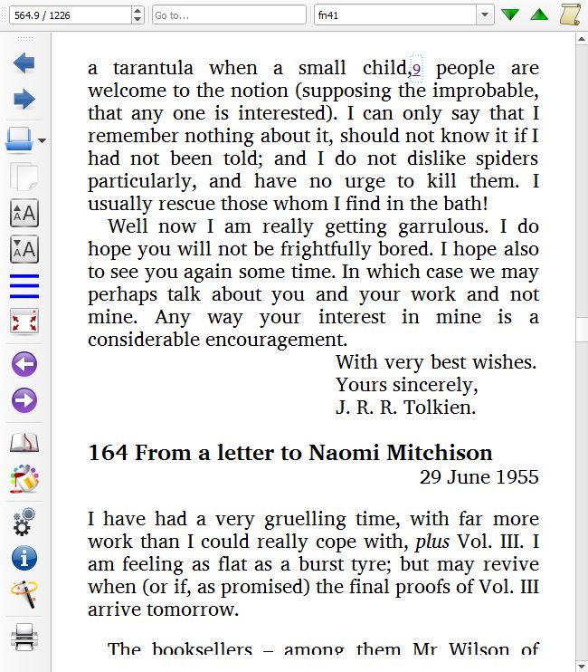

Umm...OK. I'm sitting here right now looking at a page with the bottom line cut off, and it's not in scroll mode.
I have attempted to attach a jpg of a screenshot.

I really dont see how that's possible, unless the book you are viewing is using images of text instead of actual text. Attach an ebook file that reproduces the issue.
