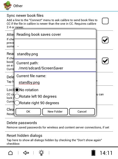

I think that there is an easier way to do this. I have an Energy Sistem Pro+. All I had to do is tell CC to store the cover in /mnt/sdcard/ScreenSaver as shown in the following screen capture.
The screen saver image sometimes doesn't change until the second time the device is turned off (to standby, not power off), which doesn't bother me.

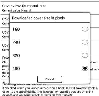

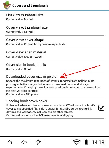

As for cover size: you have control over the size of the cover CC stores in its database. The default is quite low-res. I use the 480px size on my ESPro+ and it looks fine.
ID:	143592 Click image for larger version
