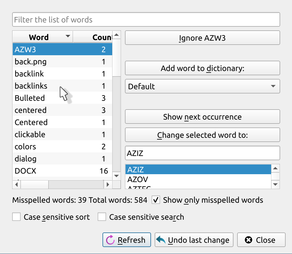

No, I am able to resize it to a smallest height of approx 400 logical pixels which on my high dpi screen is 800 physical pixels, see attached.

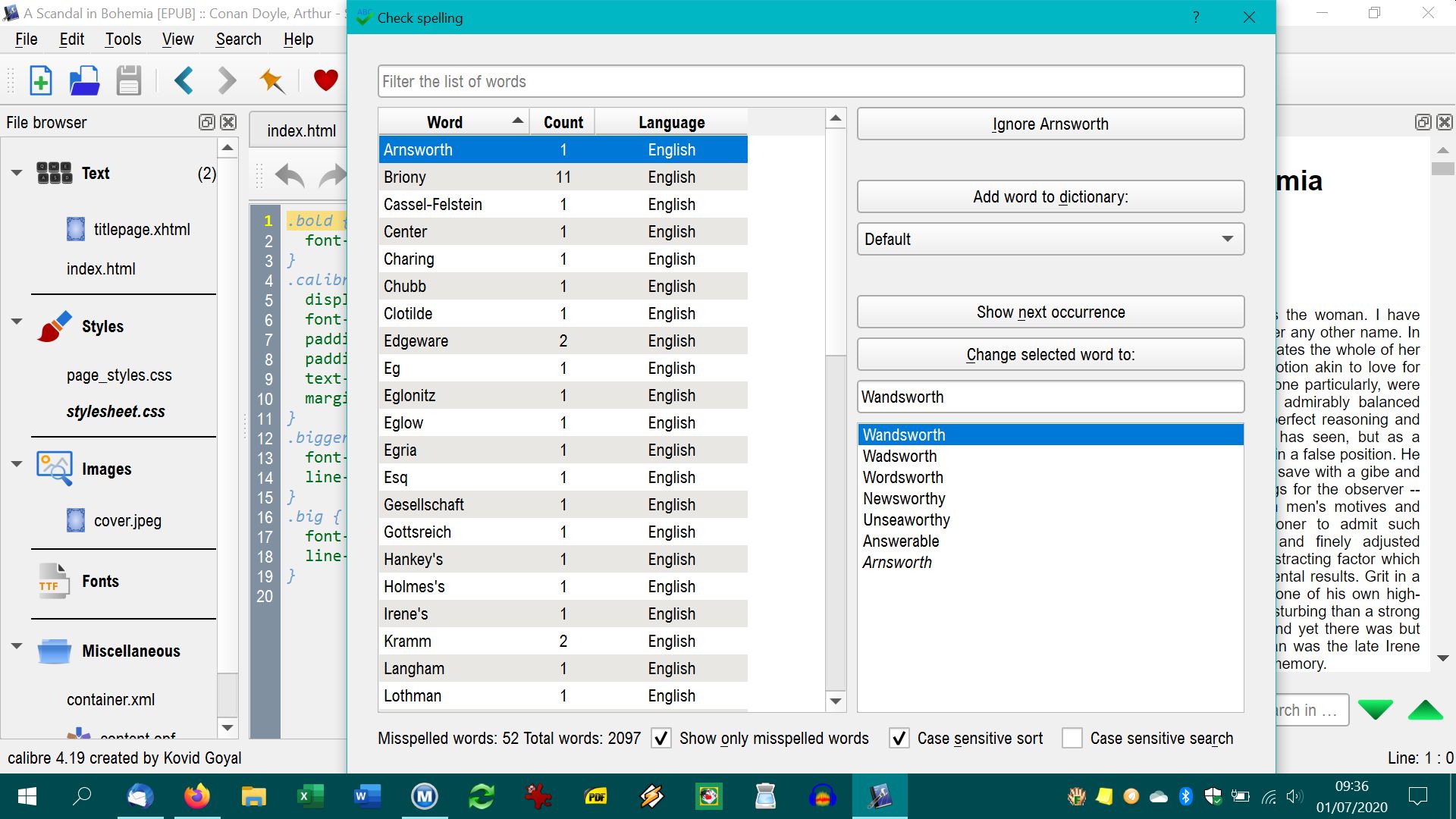

@kovidgoyal : Screenshot attached.
Thanks,
Stanno
Stanno is offline   Reply With Quote

Dont see any reason it shouldnt be further shrinkable

I installed calibre on my wife's laptop which has a 1366x768 screen and Win 10 scaling of 100%. The result is as attached.
The spell-check window is now accessible but, interestingly, cannot be shrunk any more than shown - so it won't go as small as in @kovidgoyal's screenshot.
Stanno
Old 07-01-2020, 06:37 AM   #11
Posts: 45,634
Karma: 28549046
The minimum size is likely a difference between windows and linux in Qt.
