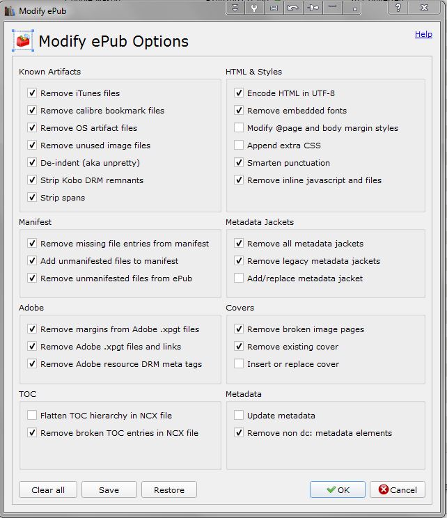

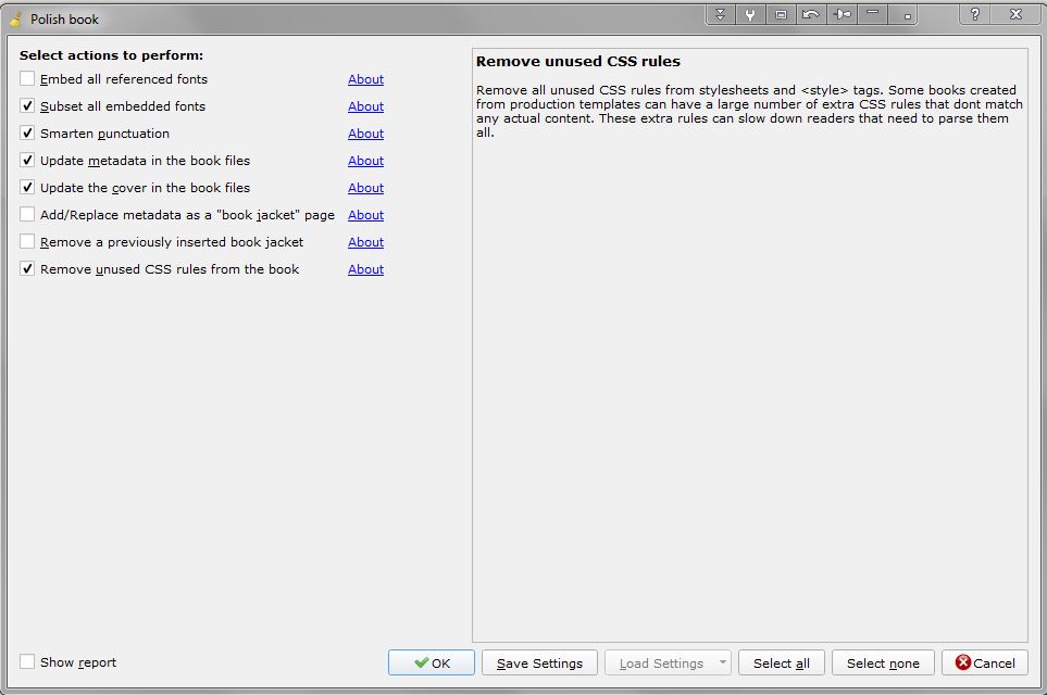

@burnafterreading - I do something similar for some friends & relatives, in essence here's what I what I do
  • Add the book they send me (via email) to a scratch library
  • Remove low value metadata (tags, rating, comments etc)
  • Search for and download the best quality cover
  • Modify the book (this is an optional plugin) with these settings, basically it strips out existing dross from the epub.

  • Polish the book with these settings, this does a bit more 'tidying up' and adds the downloaded cover and updated metadata to the book.
  • Click image for larger version
    Aside : some would argue that a Polish after a Modify is redundant, but I prefer to do both - typing 'Alt/M' (my kb short for Modify)and 'p' is easy enough, the software and scratch library live on an SSD so it only takes a few seconds.

One thing I notice about your setup, it doesn't seem to be redundant, specifically regarding metadata updates. Modify is stripping out non-dc metadata, and then Polish does the job of embedding new calibre metadata... so you still get the non-dc metadata that calibre generates??? I assume Modify would not do that on its own.
Plus Modify cannot strip junk CSS.
Old 12-21-2014, 05:40 PM   #11
Posts: 31,299
Karma: 62000000
(Calibre) Series is non-dc metadata
do you really want to strip that?
Old 12-21-2014, 06:43 PM   #12
Posts: 22,039
Karma: 30277960
BetterRed,
Or embed/subset fonts
I didn't mention those because they're a bit arcane
The Polish puts the calibre metadata back, including series.
The reason I strip the metadata back to dc elements only, is to get a clean slate without having to edit the epub.
