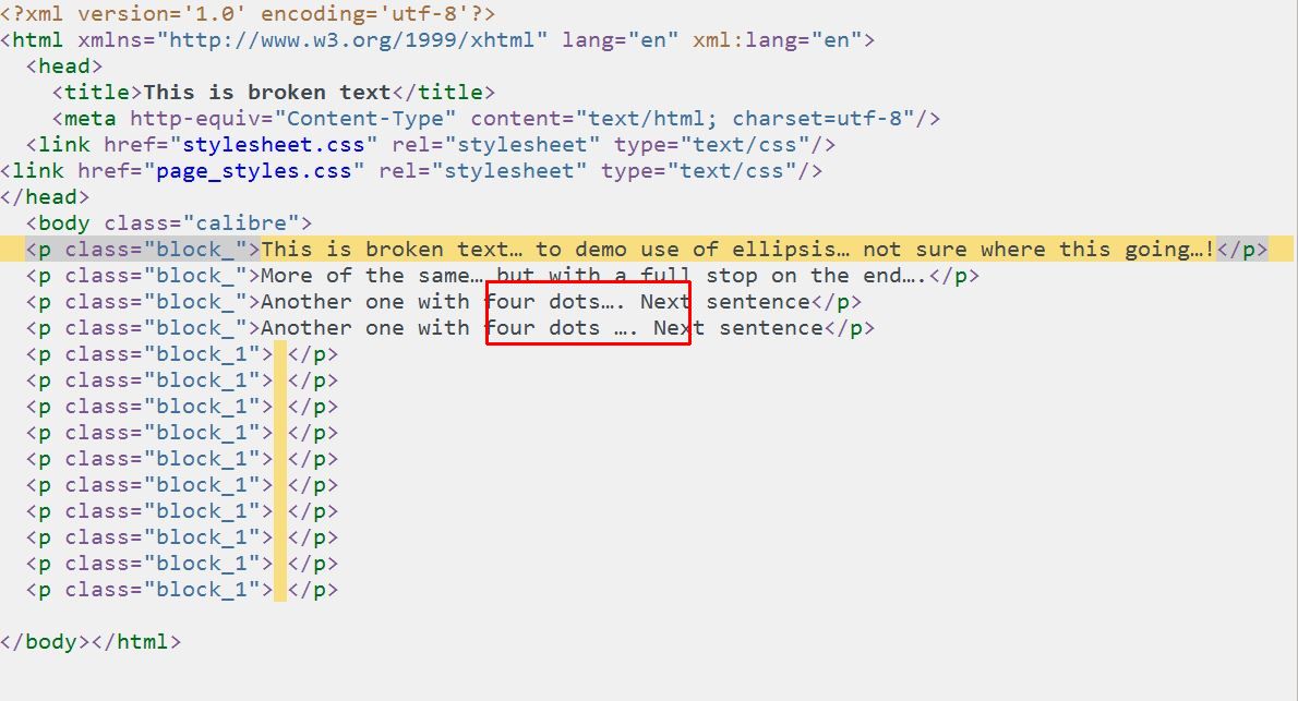

I dont see this behavior. Smarten Punctuation will convert
Some sentence....
into
Some sentence….
Old 08-28-2014, 05:39 AM   #6
Posts: 22,044
Karma: 30277960
Originally Posted by Prestidigitweeze View Post
Is the issue created by settings within Calibre itself or within those of one of the Kobo plugins?
Some sentence....
into
Some sentence….
Then it must be something with Kobo PI's or device
@Prestidigitweeze - assuming the Kobo is reading an EPUB, open the EPUB in the Calibre editor - select book, press 'T' - and look at the 'code'
Attached is an example, I've highlighted my 4 dot conversions
Added And/or have a look in the Calibre Viewer
