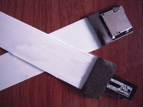

I am adding an adapter to connect the internal uSD to a uSD socket, to create the same kind of slot as the external uSD. When the adapter cable gets here I'll do up a post like I did for the temporary "Quick" one I did already. With one of these in place the only reason to open the case again might be to replace the battery.
Luck;
Ken
