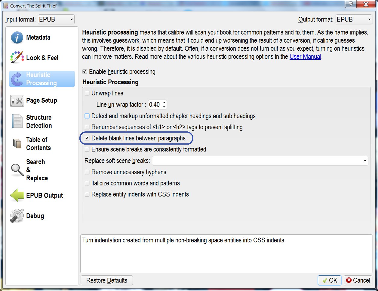

When converting try the Delete blank lines between paragraphs option under Heuristic processing.

Hi DoctorOhh - it does not work...
When checking this epub in Sigil, I have found that after every paragraph instead </p>, there is </p><br class="calibre1" />
So I used find and replace and after some time I was able to fix it all. I know I could've use Repace All, but I wanted to make sure not loosing something I did not want.
Thanks
It doesn't work on <br> but as the tool tip explains it does work when the space between paragraphs is created by blank paragraphs.
That sometimes removes section breaks as well. Better off doing it via the code/CSS.
