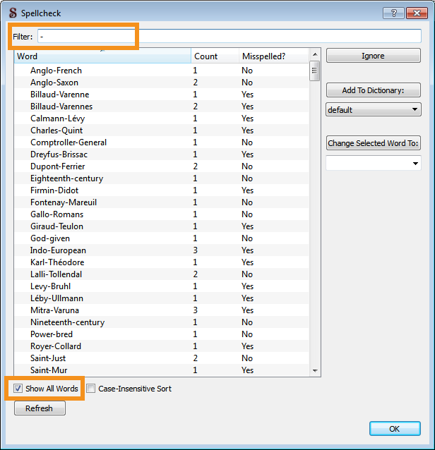

@jlocicero - I'm wondering if Sigil's Spell Check might be of some use - you could filter by spelling mistakes containing a 'hyphen'
I second this suggestion. Sigil Spellcheck can point out every single instance of a hyphenated word:
Just add in a hyphen in the Filter box, and make sure "Show All Words" is checked.
I use this all the time to remove accidental hard hyphens leftover from OCR.
I typically do a "two pass" check. Once with "Show All Words" unchecked, and one with "Show All Words" checked.

@Tex2002ans - I'd never looked at Sigil's spell checker until I thought of it as something that might help with OP's I-want-ems-not-hyphens problem.
I really like it, I recall seeing the presentation of misspellings in a similar list arrangement like Sigil's once before, in an add-in for Lotus Notes—loud groans are welcome—I find it much better than the more often used in line highlighting.
I was the one that recommended it be added into Sigil!! And if I recall correctly, it was put in ASAP. It is/was incredible.
Before that, I was using the Index Tool to generate a word list, and using the filter in that to catch hyphenated words. Quite convoluted, but it worked better than anything else I had run across!
The Spell Check Word List was something I had in the back of my mind for YEARS as a very useful tool, but never saw it used anywhere in my life. It is also one of those "killer features" of Sigil that makes it indispensable for me.
It is the best tool for catching/fixing hyphens, and it is also useful having a "Word Count" of spellings. I can easily see the words and how many times they occur. It is fantastic for catching:
