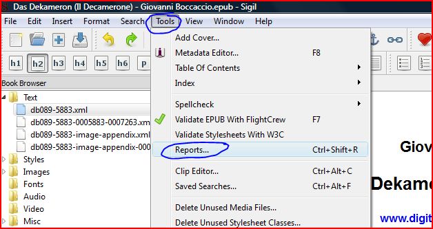

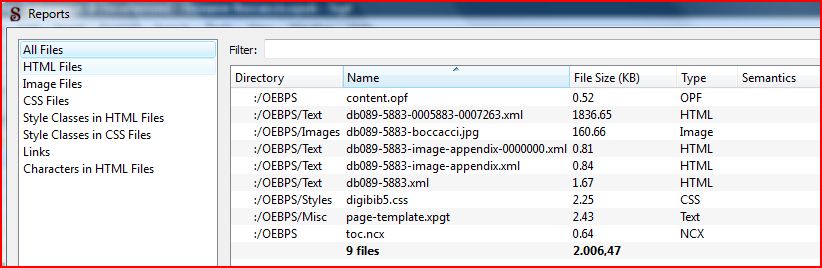

Why not using the reporting function in Sigil? There you can see where you have your big parts.
Of course. Excellent idea.
