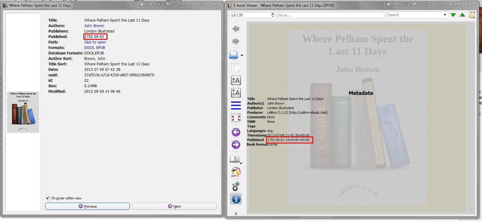

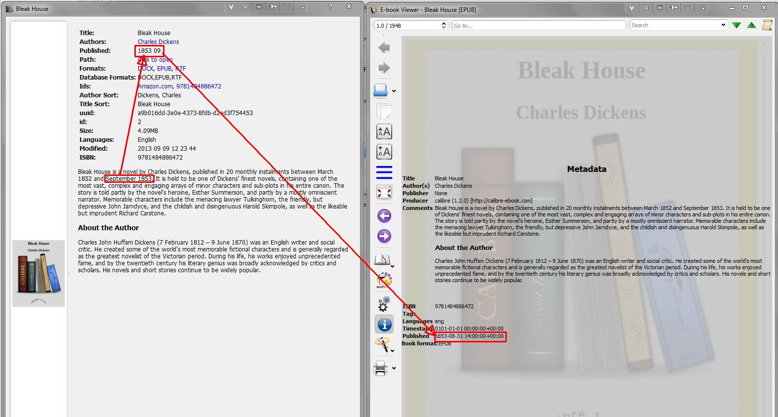

First, if I want to put in a publication date, and I put in 1-1-2005, 0:00, I just think it's illogical to save it somewhere in 2004, and then compensate with my time zone when displaying the date.
- see attachment - Sigil or similar not used - EPUB converted from DOCX
EDIT : the pubdate of 1853 09 was entered directly into Published cell for the book
The 2nd attachment shows a pamphlet that might have been published in London on 2nd of September 1752, the metadata in the ePUB shows 1st September 1752. But in London there was no 1st of September in 1752, it was one of the 11 days lost when the British Empire changed from the Julian to the Gregorian calender. Pelham was incumbent British PM, my imagination is that the pamphlet would have been a satire involving the PM taking time-out at Bedlam
