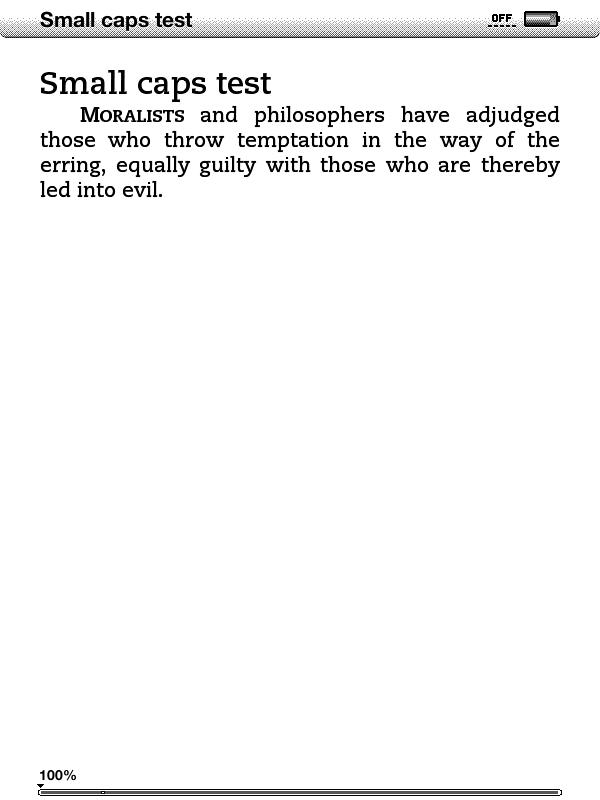

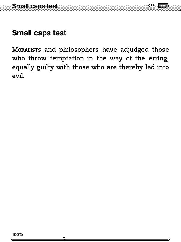

That's incorrect. Unlike ADE based devices, KF8 enabled Kindle devices and apps support small caps without embedded fonts. All you have to do is apply a font-variant: small-caps style.
In this special case the best solution would be to format all small caps text as all upper case text and use text-transform: lowercase; for the KF8 part and font-size: 0.6em; for the non-KF8 part via media queries.
span.sc { font-variant: small-caps; font-weight: bold; }
@media not amzn-mobi { span.sc2 {text-transform: lowercase; } }
@media amzn-mobi { span.sc2 {font-size: 0.6em; } }
<p><span class="sc">M<span class="sc2">ORALISTS</span></span> and philosophers have adjudged those who throw temptation in the way of the erring, equally guilty with those who are thereby led into evil.</p>
(Since text-transform and font-variant aren't supported in Mobi7, they'll be ignored by KindleGen in the non-KF8 part.)
ID:	105237   Click image for larger version
