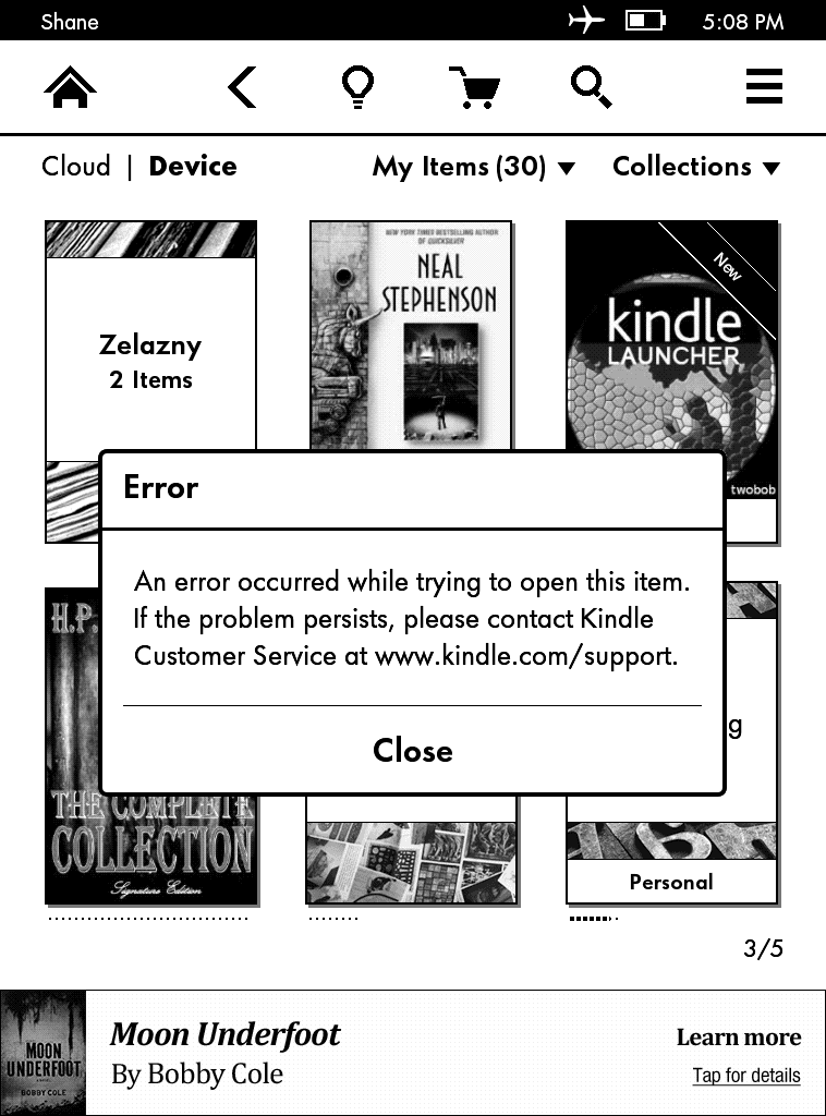

I did put it in documents and run it by clicking, at which point it said that it didn't work. The part that says "It should read thru the /mnt/us/extensions folder and build a list of your extensions" made me think that the extensions folder was in a location accessible only through USBnetwork. Am I wrong and this file path should be created starting at the root of the drive space found when plugged into a computer (the directory with the "documents" folder)?

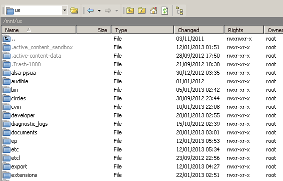

There have been only two occasions that I can think of where it failed to work
1) when the extensions directory was actually missing
(I will go add a picture of where it is - No, it's not a special place - it's the folder structure you see when you attach the kindle via USB - The FAT root
(/mnt/us when you attach via USBNETWORKING)
note that the USBNETWORKING application is not of the list of REQUIRED things.
2) When one of the - extensions config - files was wrongly line ended. (DOS line endings)
There is a tool dos2unix that I have attached to post 3 to check this.
Worst case scenario you would simply swap the extensions into a backup folder (any, just make one) and then move them back one by one, see which one breaks the Launcher. Then let me know so I can document it or try to do something about it.
I updated the main docs to reflect this more clearly. thank you.

Ah, so -
The (internal system) path: /mnt/us/
**IS** the root of the (external storage view) drive space.
Translation:
Internal: /mnt/us/extensions
External: Kindle:/extensions
Same-same-oh.

I have an extensions folder in the root of the Kindle and nothing inside, so it shouldn't fail. I have screenshots attached to show you that this is not the case.

It says there was nothing to open.
Is that not normal for an empty directory?
Put something in the directory - it will work.

Okay, the way twobob put it, I thought it would run without anything in it for troubleshooting purposes. I'm trying to use the dos2unix application, but it's just an extensionless file inside a zip, so how do I use it? Can someone point me to an extension that's confirmed working with the PW as well?

java.lang.NullPointerException: null
has, so far, meant a lack of the following file being installed:
http://ge.tt/3ZRY9XE/v/71
That is installed right?
See here: https://www.mobileread.com/forums/sho...0&postcount=35 for a similar report.
Err.... This is an applications launcher.
It expects at least SOMETHING to run.
(Large Red lettering under SUPPORT on main thread)
So:
1) Please confirm the Kindlet Jailbreak is installed. A simple "Yes I did that" would be very helpful.
2) Grab something (The helper scripts, Kterm, anything) and put it in the folder. Then try again.
It wasn't (yet) programmed to handle (all) corner cases. Do something in the way "It expects" - e.g. put something in the extensions folder (it is searching for something to be in there, not nothing)
Also. This would be better served on the main Launcher thread next time there is an issue
So. To recap. Kindlet Jailbreak, Kterm (or helpers), re-run.
Far as I can see - so far - it has acted as I would expect for a device missing such data.
I am guessing you are still missing the "required" step...
