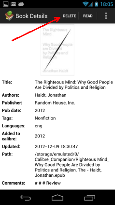

In order to keep calibre's metadata up-to-date and to support grouping and sorting by calibre data, CC has a database of books. You can delete a book from within CC by tapping on the book to open Book Details then selecting "Delete" on the action bar (see screenshot). This will delete the book from the file system and from CC's db.

Thank you for the response. Before (as in, when I was typing the post above) when I tapped the book it would immediately open it in the reader. Now a single tap it is showing the details page... not sure what was happening there, but it's working now and I am fine with deleting the book in CC instead.

A tap opens book details, and long press opens the reader. My guess is that your device has a shorter long press delay, making it easy to get a press instead of a tap. But who knows ...
