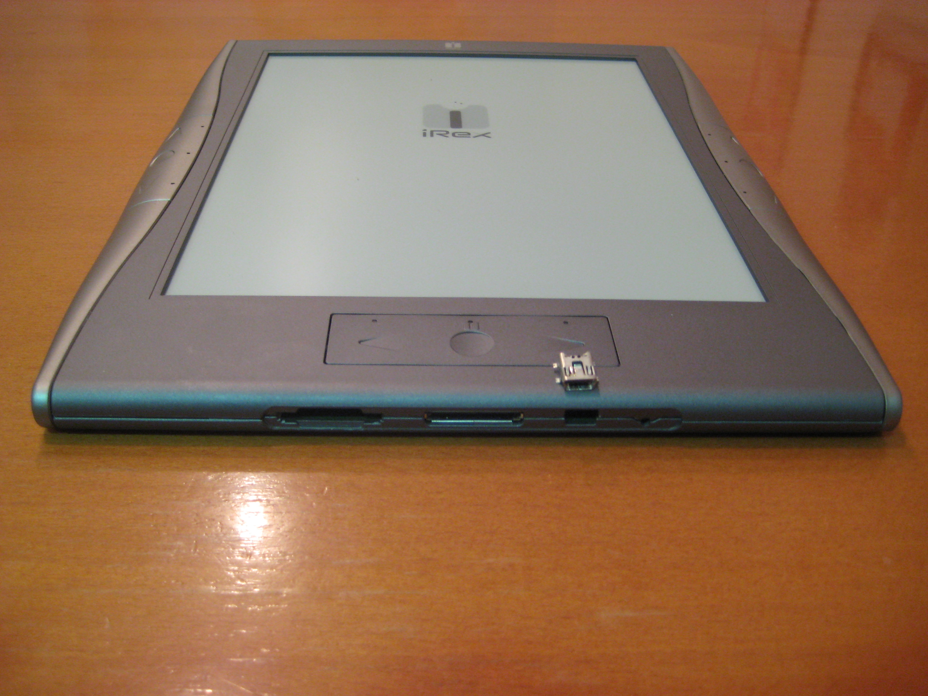

A piece from the charging hole has loosened and now I cannot charge the DR1000S. I have already submitted a ticket to IREX. Last September, my cybook screen broke, so I treated this device with extra care. But it seems that to no avail.

You have managed to dislodge your mini B USB socket; wait to hear from iRex: if their price is too high for you, it should be repairable--if you or anyone you know has experience soldering circuit boards (the most difficult part will be removing the back cover without damaging anything, and it isn’t easy to do).

Wow, How did you manage that. These ports are usually quite well soldered onto the motherboard?
As Kent says, wait to hear from iRex, but you'd have to check the motherboard to see if it hasn't been damaged when the USB port came off,otherwise re-soldering it would be possible, though not easy with domestic soldering irons in my experience.

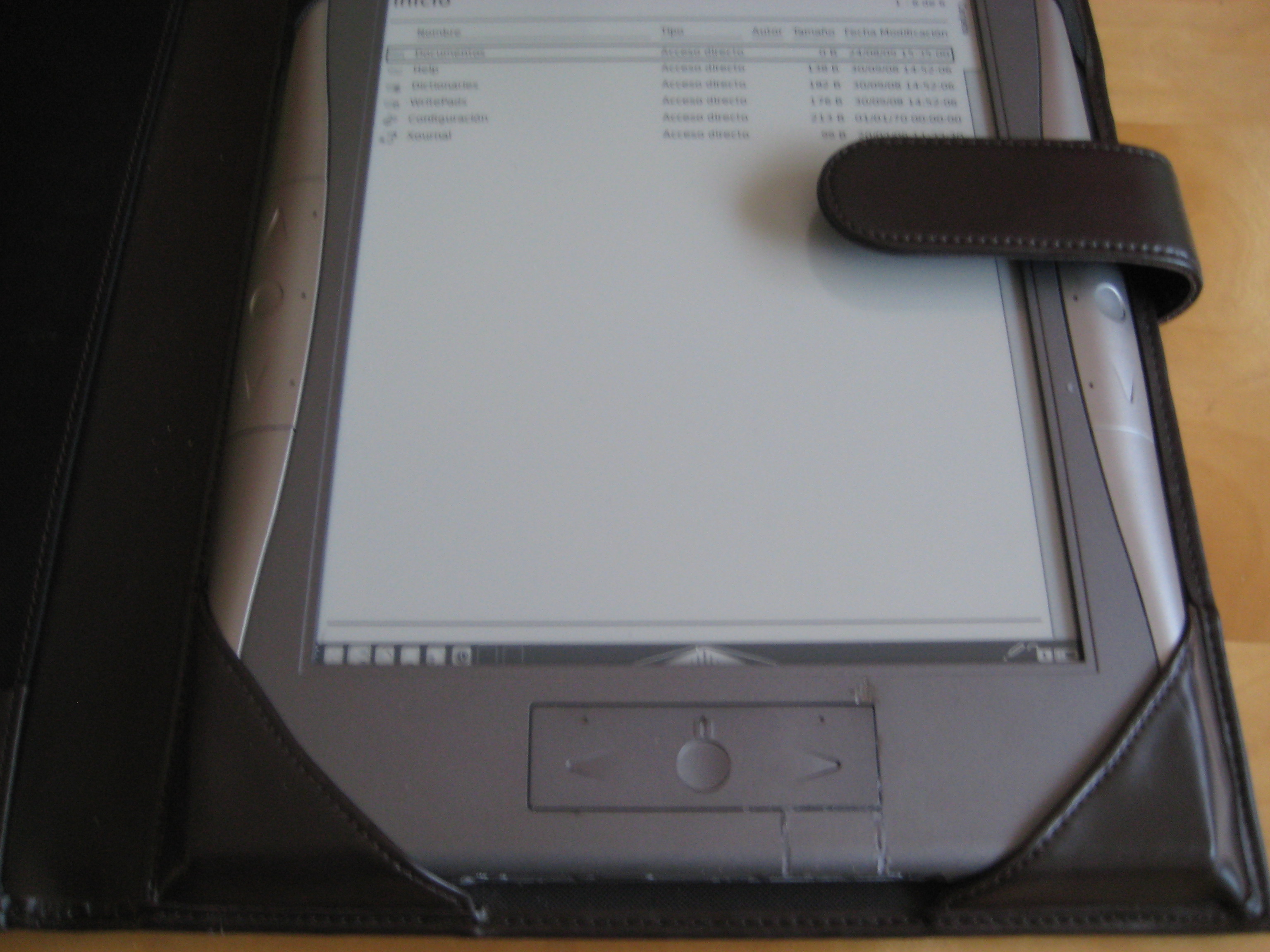

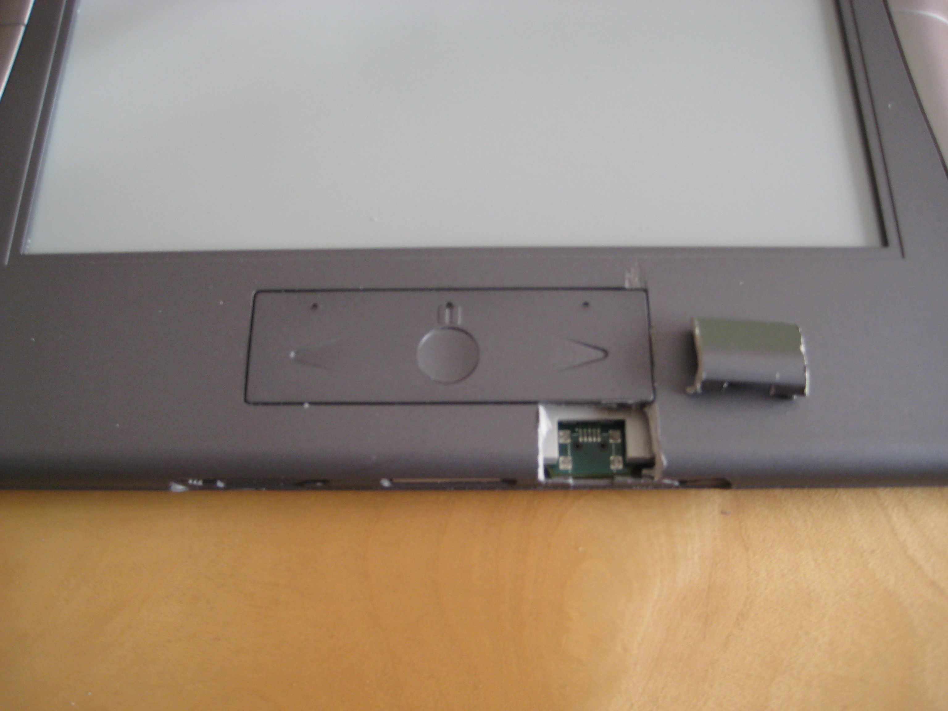

I have experience soldering but did not want to risk damaging the device. As Kent Walters said "the most difficult part will be removing the back cover without damaging anything". I risked instead the aesthetics and here is the DR100S after the operation: with a scar, but fully working.
I sawed a little square of the plastic cover over the charging hole, soldered the "mini B USB socket" (thank you, Kent Walters) and put again the little cover.

I have not upload the pictures of the "operation". I do it now.

Delighted you managed to fix it, & Well done on the soldering.

I’m glad that you were able to repair your board, but I’m concerned that you have weakened your DR’s case, wich might contribute to a screen break. Please read Grimulkan’s Broken DR thread, and consider my suggestions there:
