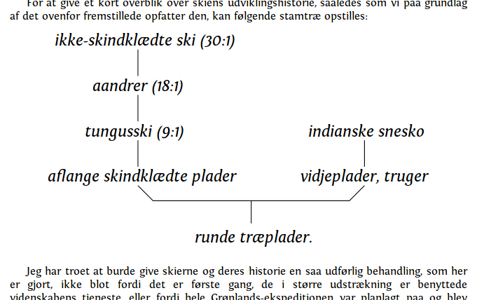

A couple of samples from "Paa ski oer Grønland" by Fridtjof Nansen. First, an evolutionary tree of the ski:
<svg xmlns="http://www.w3.org/2000/svg" width="100%" height="33%" version="1.1" viewBox="0 0 600 300">

SVG is a slightly tricky beast. Mainly because support is so patchy. In both the above examples, using SVG's support for centered text would make sense, but that feature is not supported by e.g. PRS-505. And of course it is tedious to code a table by hand, but with a soupcon of creativity and digital legerdemain it shouldn't be too time-consuming; a spreadsheet could do much of the work, I suppose.
ID:	83881   Click image for larger version
