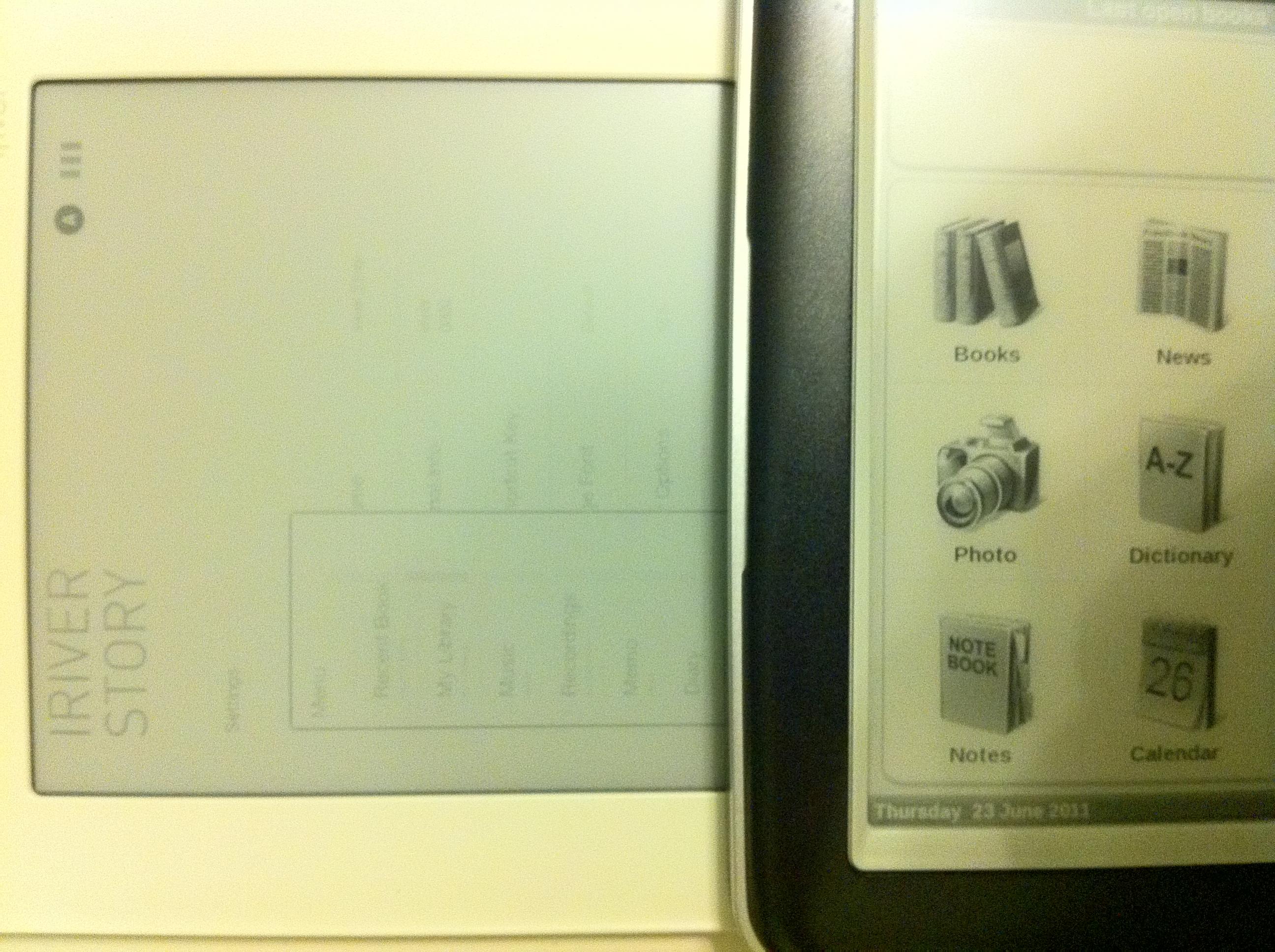

My iRiver Story screen died
My iRiver story, which used to have better contrast than my PB360, has now faded significantly (it is 19 months old). See how faded it is now compared to by PB360

Wow, that's a bit of an eyebrow-raiser, eh?
I've heard it said that iRiver uses very low-quality components, though I don't have the technical knowledge to know for sure myself. I probably wouldn't mind so much if the iRiver wasn't one of the most expensive eReaders available - in my country, anyway. (And at the time I bought it, it was just about the *only* one available locally, as well.)
I'm not a fan of Sony as a brand, but I'm thinking once the PRS-650s are back in production I'll ditch my iRiver for one of them. Bit of a pity the Story has got pretty much zero resale value!

Yup Pearl E-ink touch is probably the way to go, though there is this rumour of a new sony line floating around... I have heard about e-ink fading in sunlight and have experienced the poor contrast of the sony 600, but I have never heard of an iriver e-ink screen fading beyond usability after < 2 years! (It was fine and had much darker contrast than both my PB360 and sony 600 for > 1 year though..)
