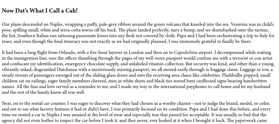

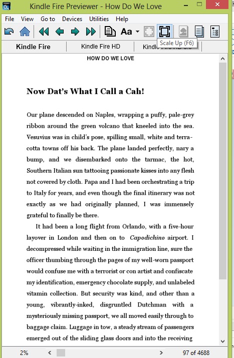

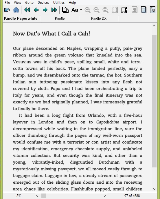

Thanks, Albert and Hitch.
I have searched for the original post that I read--stupidly, I didn't copy the poster's info, just the text. But, that said, I completely redid my stylesheet to eliminate all of the msword and caliber crap that filled it with useless codes that did nothing. My "clean" stylesheet validates at W3C CSS Validator: "This document validates as CSS level 3 !"
The epub converts on Kindle Previewer and shows up on Kindle Devices as laid out. On my own Nook device and on ADE it is changed. See screenshots (if I uploaded them correctly--if not, I'll try again). Anyway, on ADE and the Nook the text is flush left, ragged right, space between each paragraph, no indentations. Converted for Kindle (KF8 and mobi), the text appears exactly as designed in the style sheet: first paragraph, not indented, subsequent paragraphs indented, spaces created with padding before and after headings.
I have ebooks from BN on my Nook that have the layout I am trying to get. I've gotten books from Gutenberg and pirated CSS from them, but it still doesn't show properly in my own previewing. Should I just take a chance that when my client uploads to BN it will work?
ID:	106214   Click image for larger version
ID:	106215   Click image for larger version
