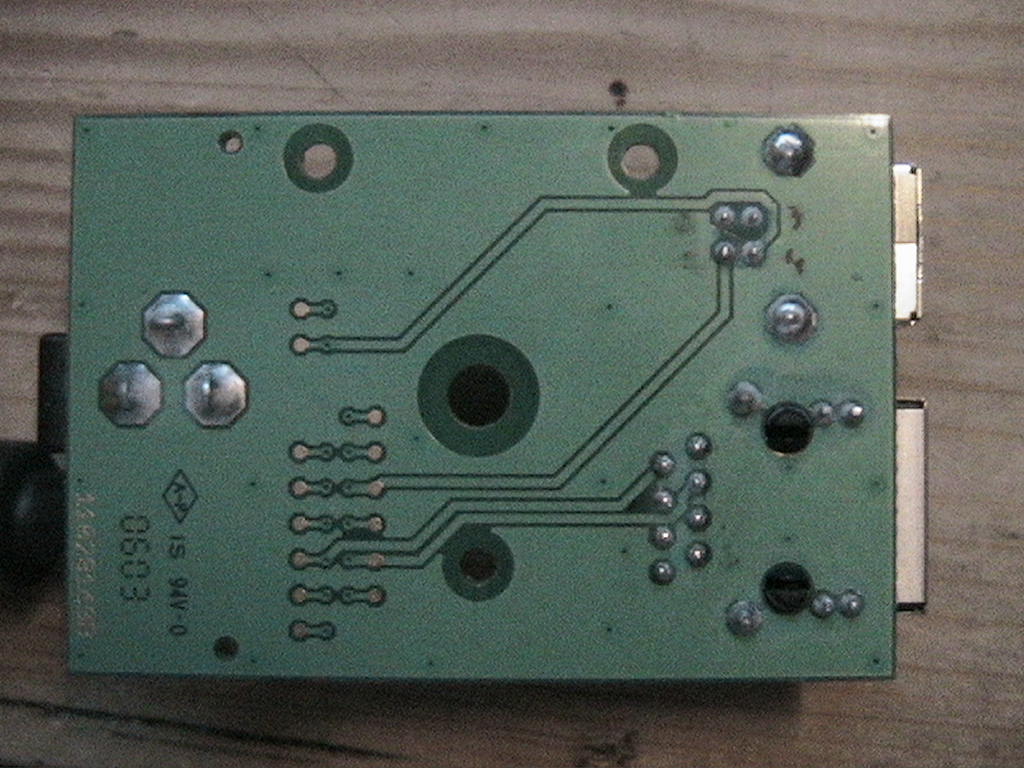

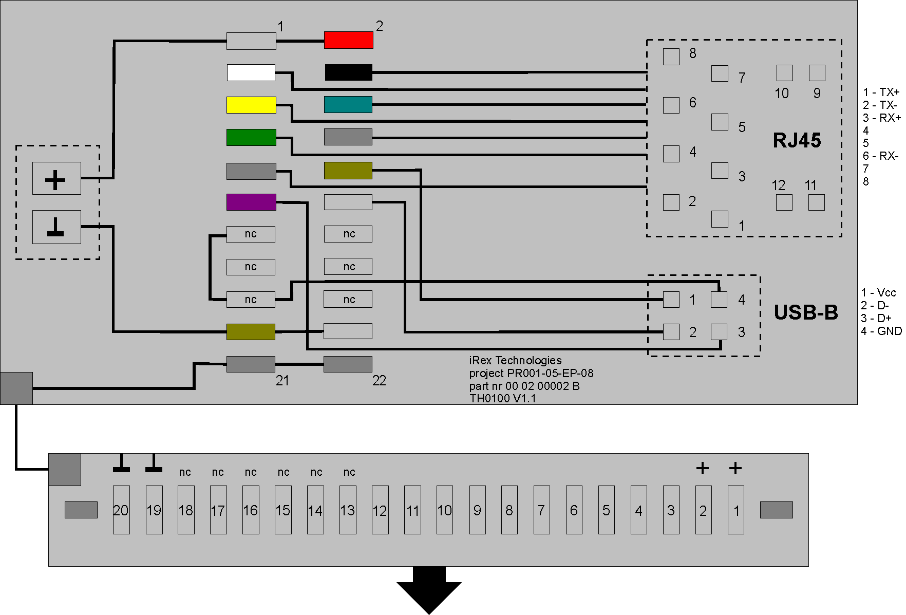

For all Hardware Freaks :-)
Wiring Diagram of the Travel Hub.
Snoopy

nice. so that makes 6 unused contacts. minus 2 connected to USB GND. Right?

Thats Right,
4 unused contacts in the Hub, but 6 in the connector.

couldn't it be that the 2 contacts connected to USB GND and maybe some others are some sort of "sign" for a connection?
edit: ok, I read the diagram wrong. sorry

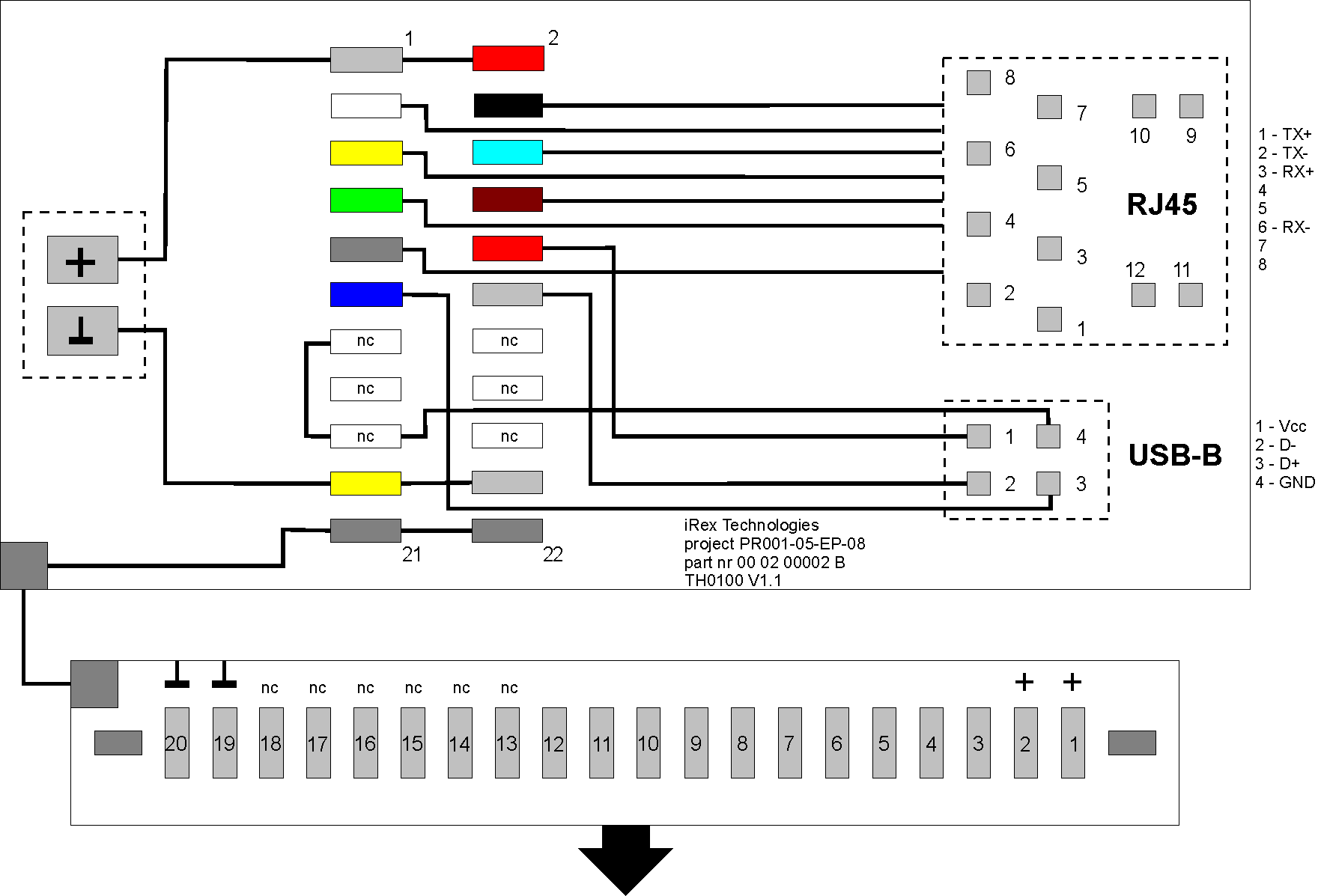

the connectors marked with "nc" are not connected to any wire.
USB no.4 is NOT connected to Ground or any Wire.

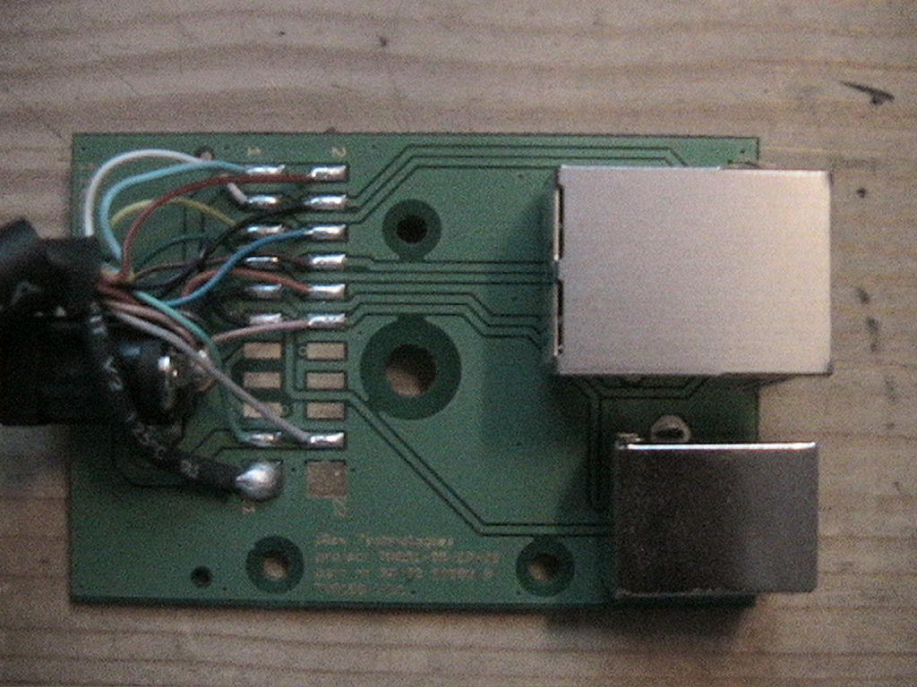

Another picture with better colors...

Guys, 10/100 ethernet only uses 4 wires, but there's 7 going to the RJ45 connector. The extra three might be Rx/Tx/GND serial on the unused pins. Can you check this?

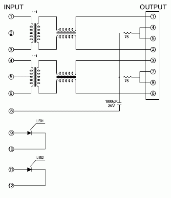

the three extra wires are for the LEDs on the connector.
edit: perhaps, the internal Wiring of the rj45 connector looks like in the picture.

D'oh! Silly me, I should have realised that.
Oh well, at least there's some suspicious solder pads on the Iliad's internal photos...

but unfortunately the connector was fixed to the other side of the board.
six pins can do for full featured rs232.

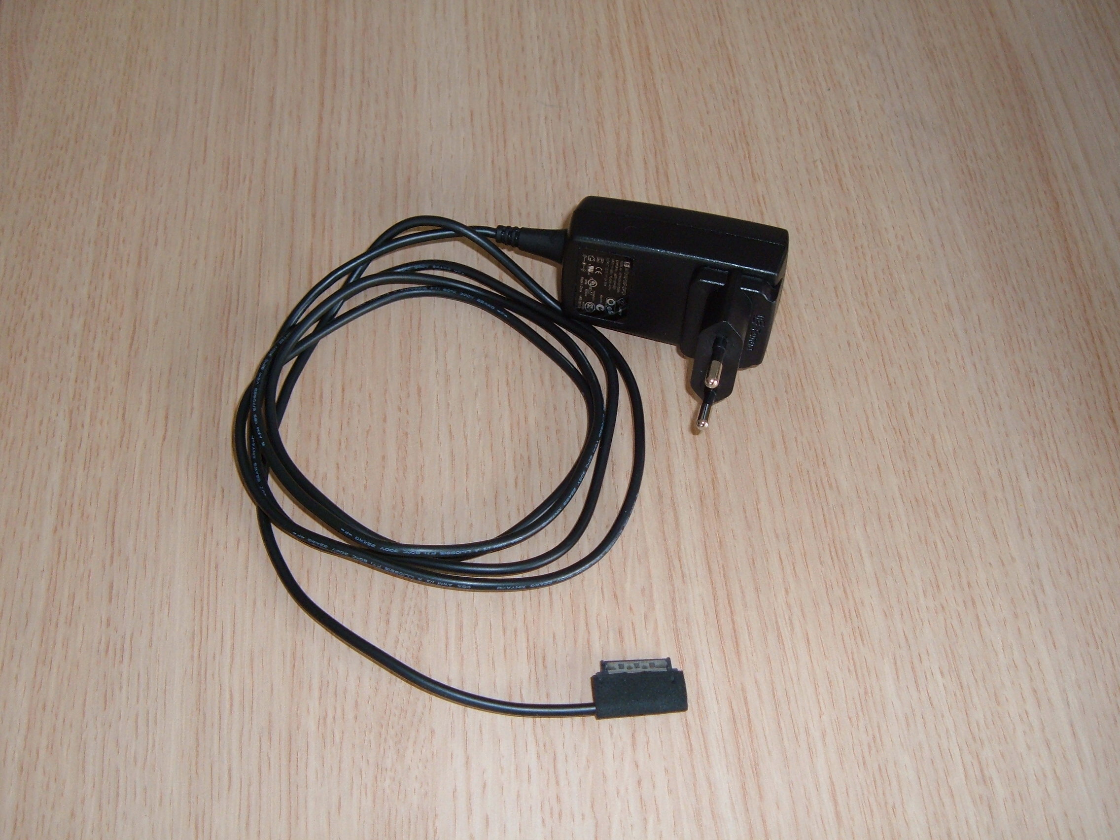

The powersupply Irex should have made available
Made myself a replacement for the Irex travelhub. It is easy to make for the experienced technician. Charger only, I don't need the USB so often and if - than only at my desk. Irex should have this device delivered in the first place.

Better to decide for yourself IF and how to do it.
Look at the schematic Snoopy published. As you see the power is on pins 1-2 (+) and 19-20 (-). Measure with a voltagemeter which pins on the Irex connector are + and - and connect those with the + and - of the powersupply.
Be aware of the risks! I case of a failure you may blow-up the powersupply and the Iliad.
Don't do this if you are not absolutely sure!
