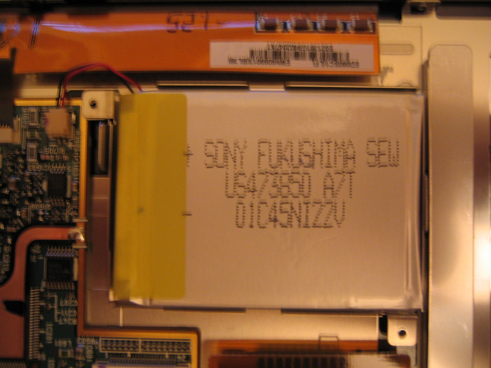

Well I opened it and tried to measure the current. Problem is that it's very hard to measure it. I needed a very, very thin wire to make a circuit and measure the current but I didn't have one at home. The only thing I could do on the spot was cutting the wire but that I found a bit going to far. I can do it but I will need some shrink tube so I can fix it afterwards.
I will give it a try soon but I need to set something up to do it correct. Igor, I couldn't find the terminal and I didn't dare to measure so close to the CPU. If I blow a port I have a big problem. One thing is for sure, you need to measure to find it.
What I did do is rip the "recycled" label from the battery and get the full type description.
It is a:
Sony Fukushima Sew
US473850 A7T
01C45NI22V
I found this type but only instead of "A7T" it ends with "A8T". I can't say what and if they are different.
Click
Is it possible to check if the terminal contacts are present on the cradle connector?
