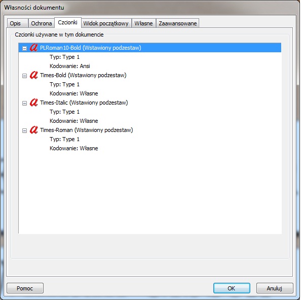

I've attached screenshot of fonts used in the pdf, seems like none of them is truetype. What should I do to convert correctly? Help anyone?

Thanks for your reply. The pdf creator is GPL Ghostscript 8.56. I will try to put this into another format and then replace broken letters, but it doesn't look like a very convenient method though.

Originally Posted by sulka View Post
Hi,
Did you remember to switch on "keep ligatures" in:
Preferences ->Conversion.
Glenndk is offline   Reply With Quote
