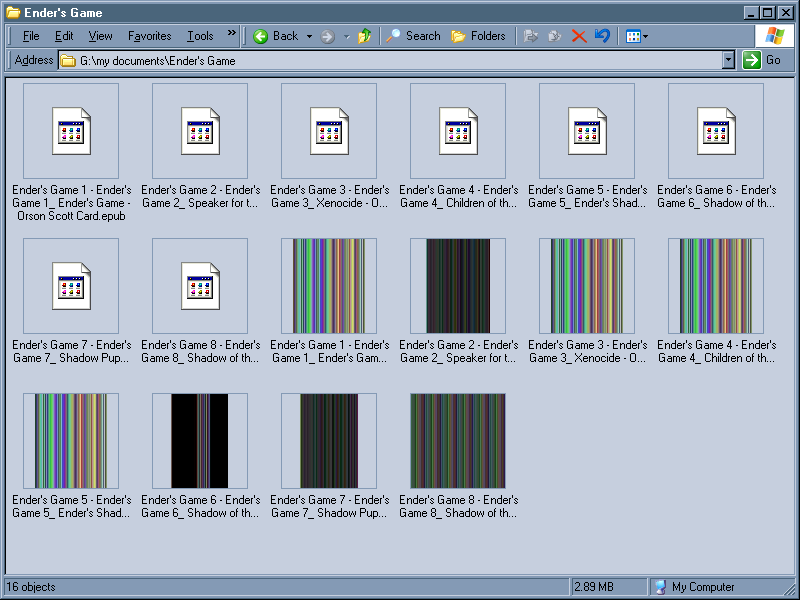

So I've used Calibre 0.7.14 to put some EPUB-format books onto my stock Nook, and I noticed that along with the EPUB files it also uploads JPG files that just contain vertical lines in various colors. It looks like these are maybe supposed to be thumbnails of the book covers, but I guess something is going wrong with Calibre when it makes them. Anyone know what's up?
Thanks.
Edit: I've attached one of the JPG files so you can see what I'm talking about.

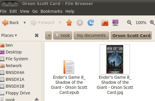

Testing out the Linux version of Calibre is in progress; I installed Calibre on my Ubuntu disk but didn't have my Nook handy at the time.
Edit: Linux 0.7.17 seems to work fine, so it's definitely a Windows specific issue for me.

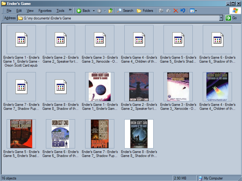

ID:	57588   Click image for larger version
ID:	57589   Click image for larger version
Name:	Screenshot (Modified).png

Updated previous post with screenshot of it working properly in Ubuntu 10.04 on the same machine that is having problems via Windows XP.
Edit: Oh, the person who PM'd me already posted a thread on this and he's using Vista: https://www.mobileread.com/forums/showthread.php?t=95983
So it looks like it can happen on both XP and Vista, but works fine on the same machine on Ubuntu.

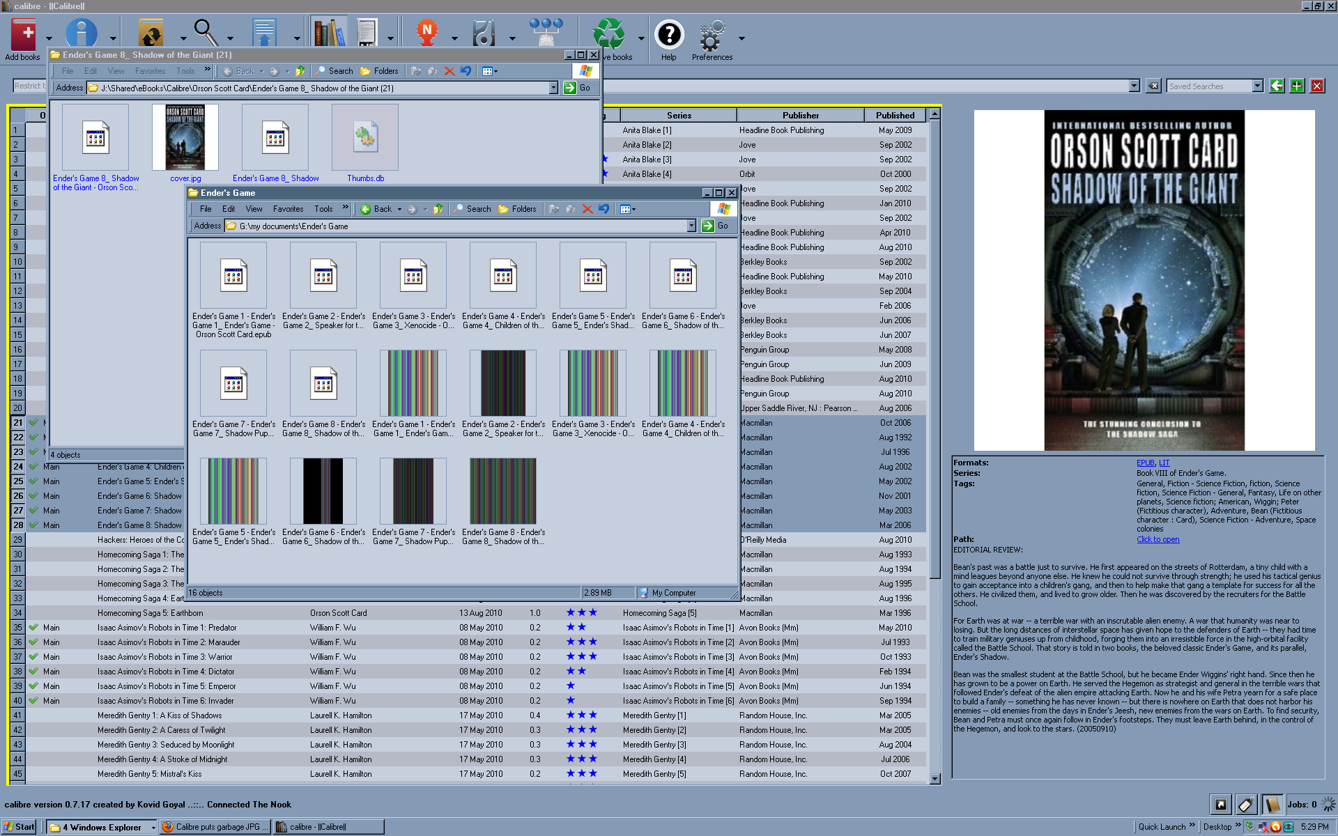

I think I may have found a piece of the puzzle. The machine on which I run Calibre is my old desktop, so I've converted it to a sort of server/workstation that I log into via Remote Desktop. On a hunch, I decided to try connecting via VNC instead of Remote Desktop to see if that would affect anything, and interestingly it made Calibre's Nook cover thumbnail generation work properly (see screenshot).
My guess is that the library (or whatever) that Calibre is using to generate the cover thumbnails for the Nook is dependent on some video hardware feature that Remote Desktop doesn't emulate properly. UltraVNC captures the remote computer's video via different methods that apparently don't cause Calibre to malfunction.
