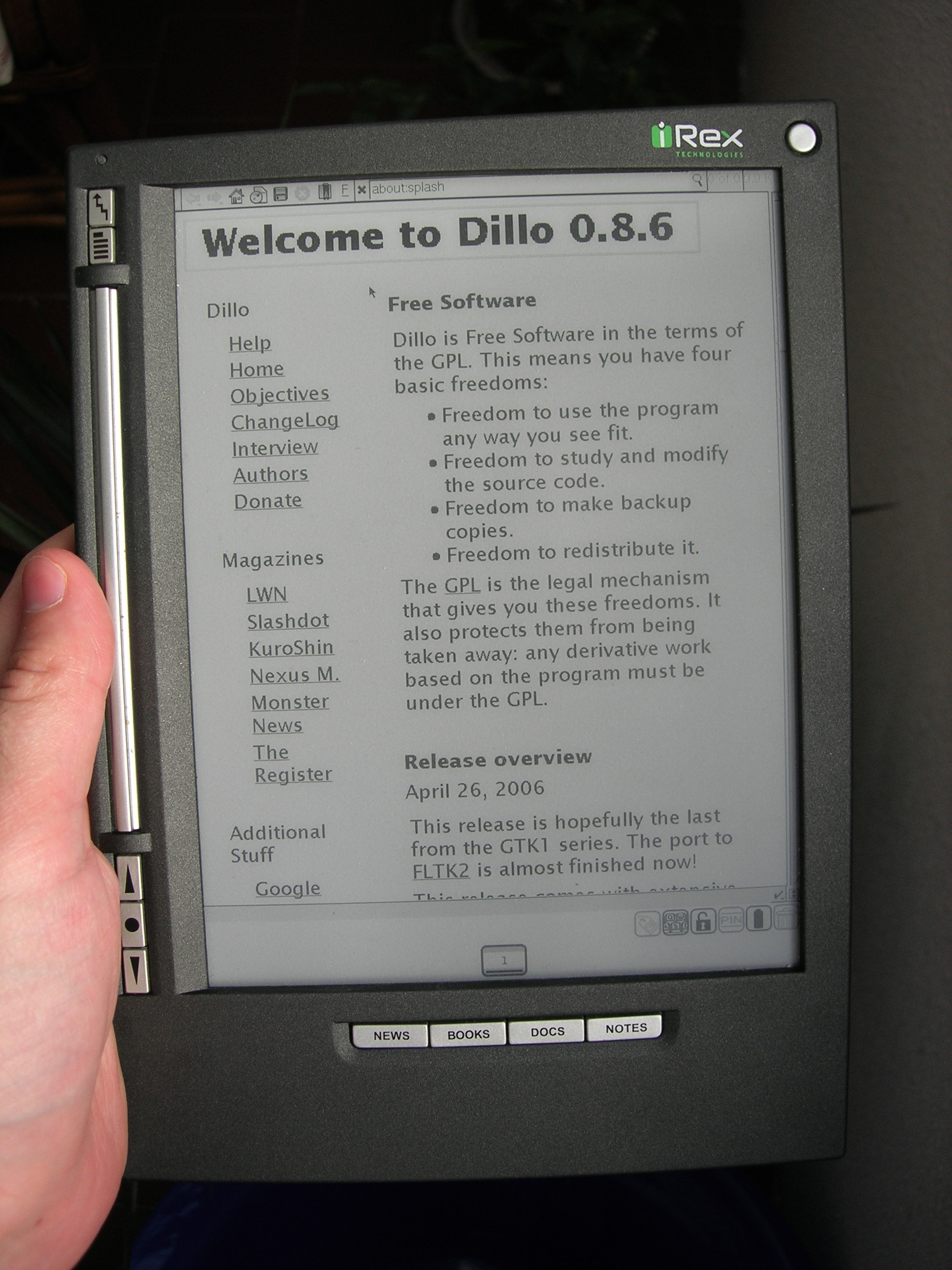

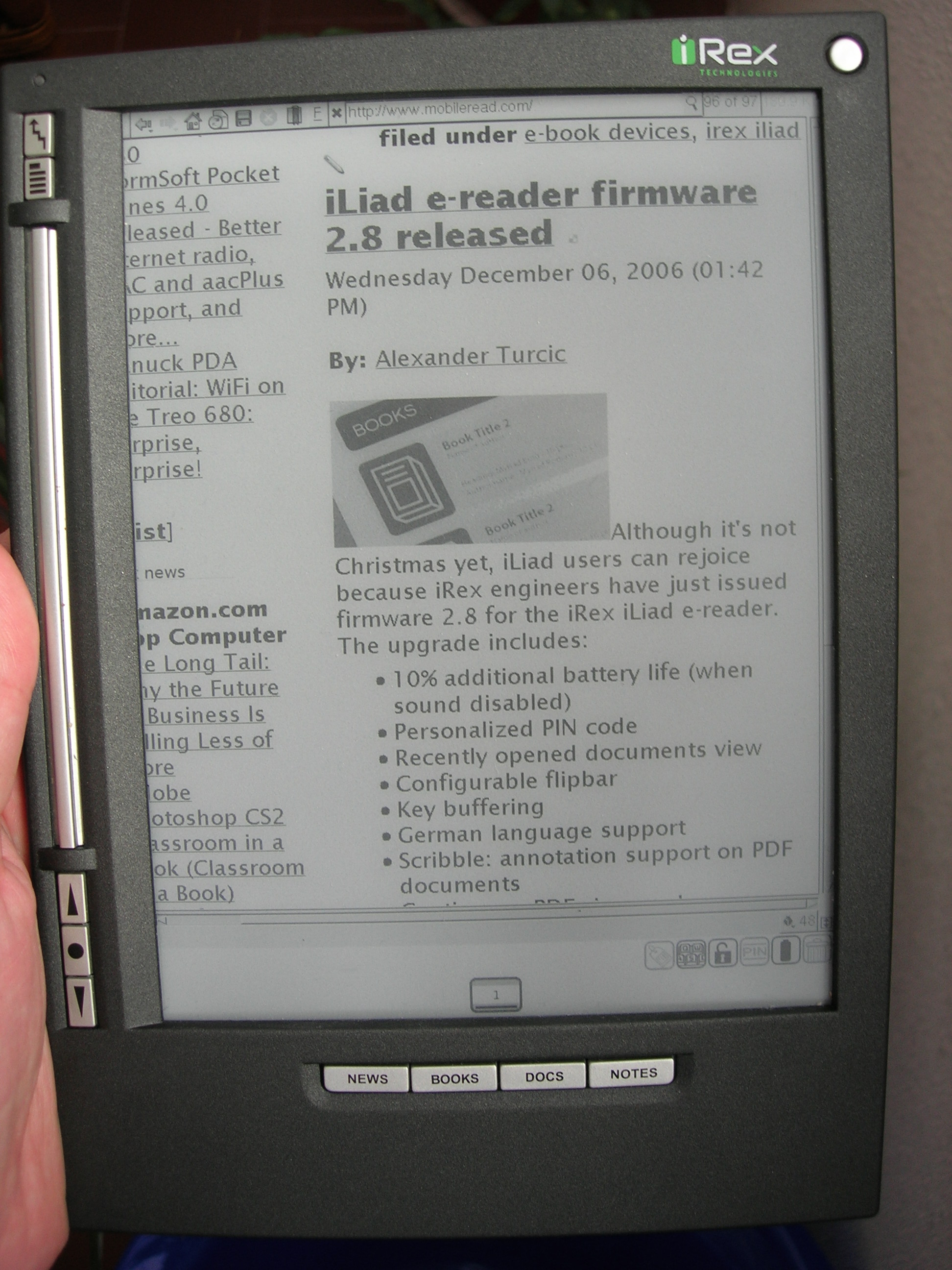

I've updated the version in the repositopry to 0.5. Now it has a reasonable font.
ID:	2460   Click image for larger version

I think these two pictures are invaluable. They show why the iLiad is justified to be more expensive than the Sony Reader, or at least they suggest that the users of Sony should try to get a wifi card working on it :-D
