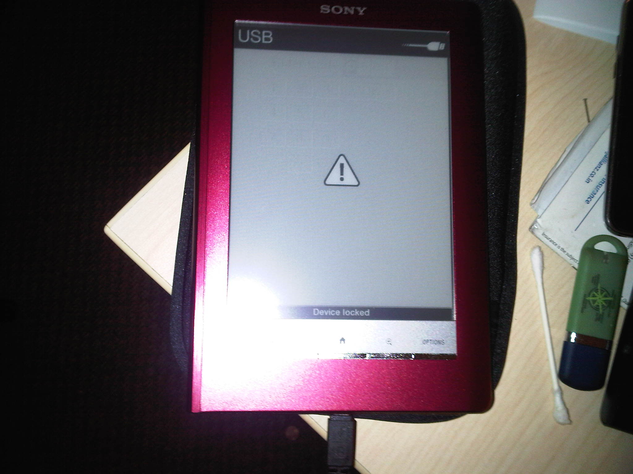

I just bought a new PRS-600 today and charged it for 4 hours but still it can't connect to my system. See the attached image. I have connected it through USB cable and it charges fine. I can see 4 drive letters but can't access any of them. Please help me in figuring out what's wrong.

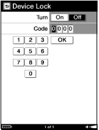

Did you set a code to protect your device? I think Device Locked is saying your device is password protected or in this case protected by a 4 digit code.
I quoted the manual below.
Setting item Description
Device Lock Locks the Reader by setting a password.
On: The Reader is locked by the password.
Off (default setting): The Reader is not locked.
Code: To input a password, tap in the 4-digit number using the numeric keys.
Once the password is set, the next time you turn on the Reader, the screen asking for the password appears. To unlock it, input the password using the numeric keys, and then tap “OK.”
Notes
You are recommended to make a note of your password and keep it in a safe place separate from the Reader. If you forget your password, contact your Sony Support Center; however note that in unlocking your device, all content on it will be erased.
When the “Device Lock” setting is activated, the Reader will not be recognized by your computer. Make sure to deactivate the “Device Lock” setting before the USBconnection.

Yeah that was it, thanks a lot.
