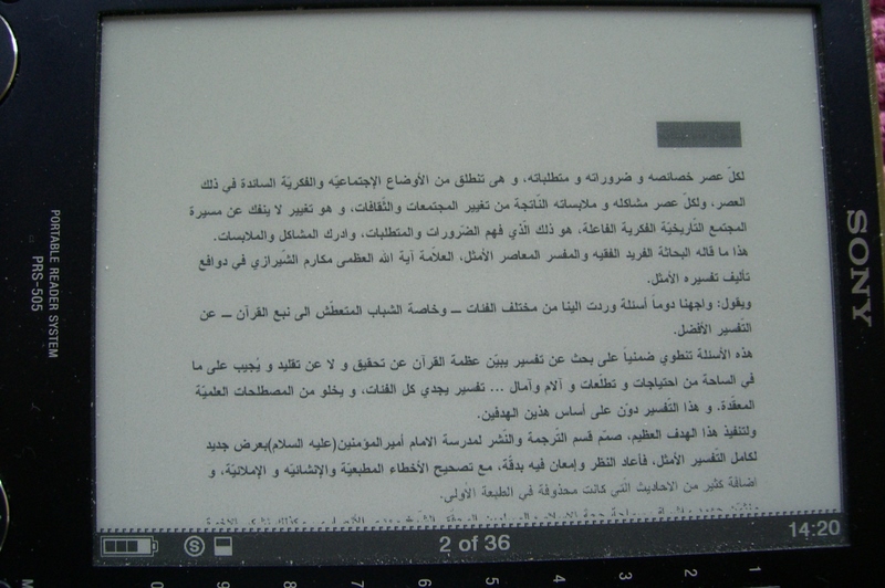

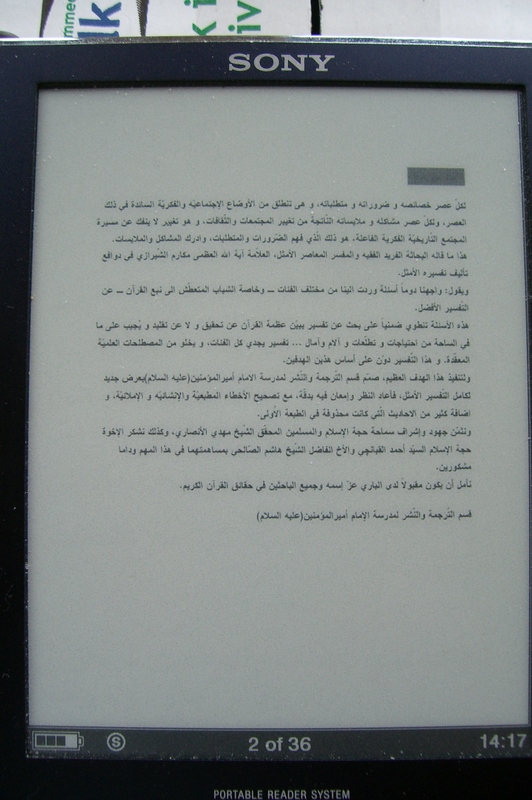

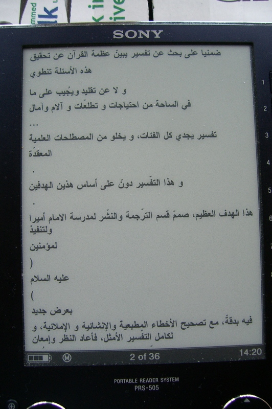

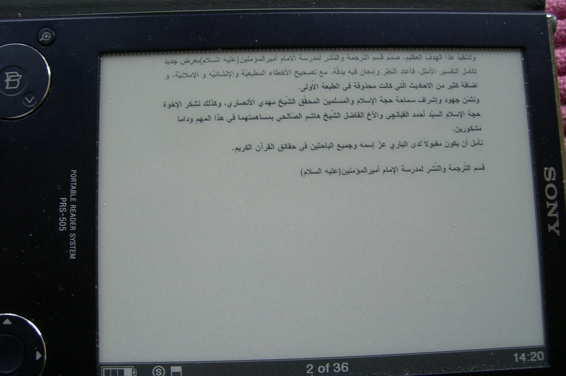

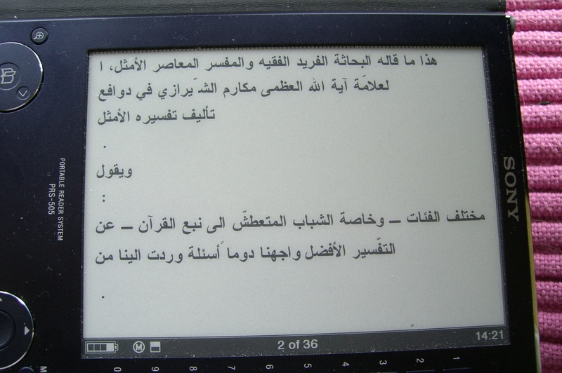

Pics of page 2
  1. Normal (portrait) view
  2. 'Medium' - i.e. reflowed
  3. Landscape - top half
  4. Landscape - bottom half
  5. Landscape - reflowed, just for completeness

RWood thanks for your help. I tried to recreate the file using the instructions in the manual but I got a large no of pages and it need fixing a lot of things. Then gwynevans posted some pictures and decided that I do not need -for the time being- to recreate the file to test it.
gwynevans thank you for posting these helpful pictures. Pictures 1, 3 and 4 are great. Pictures 2 and 5 are unusable.
