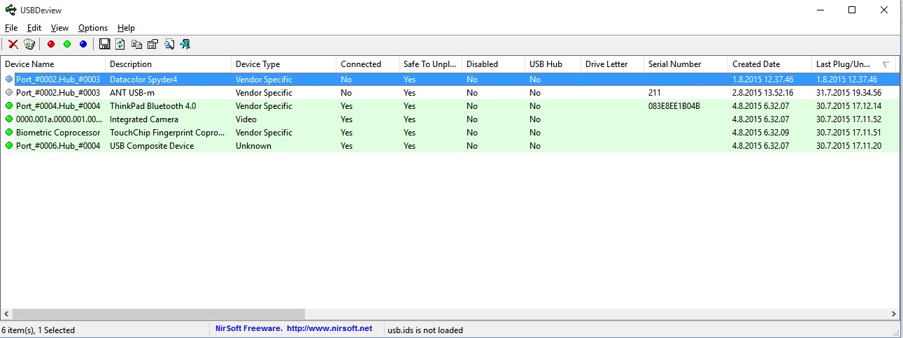

thanks for the advice. The problem is that there are no traces of Kobo driver in my system. I did a clean install of Windows 10 and every time I connect my Kobo H20 to laptop it says "Computer detected. Would you like to connect..." and after pressing the Connect-button it says "Connected and charging" but nothing shows in my laptop, not in device manager (with show hidden devices option on) or in USBDeview. Well...
http://www.mv.helsinki.fi/home/tkuvaja/usbdeview.jpg
Does the last item in your image -- the USB composite device from an unknown manufacturer -- disappear from device manager when you disconnect your Kobo? If so, I'd remove it with your Kobo disconnected.
