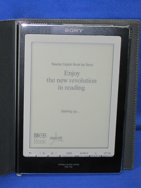

My PRS-700 shows no signs of life. No lights when plugged into the computer, no lights when plugged into a PSP charger, no status change when I push power or reset in all kinds of combinations. What it shows is the e-ink image of the screen with the words" Enjoy the new revolution in reading", "Starting up..."
I tried a soft reset, a hard reset, and leaving the reader on the PSP charger overnight, and still no signs of life (lights of any kind). I am guessing that maybe the battery is totally dead/dried out, and need to be replaced.
Has anyone had this experience before and does anyone have any recommendations? The unit is out of waranty. If I need to change the battery, I can do it, based on igorsk's post below:
https://www.mobileread.com/forums/showthread.php?t=34401
However, I cannot seem to figure out what battery to buy. Is it the same battery as a PRS-500, PRS-505 or what?
Your advice is very much appreciated and thank you in advance.

Search Sony Parts and Accessories.
Enter A1579345A in search field and search by Part Number
A1579345A
LITHIUM ION BATTERY ASSY
Currently In Stock: No
Unit Price (in USD):$76.15
(There seems to be none in stock to order but they must be available somewhere.)
Not much help I'm afraid except I've found the original part number. I'm not sure if anyone makes knock-off batteries at a cheaper price. I'm not sure if the batteries are interchangeable between models.
I would call a Sony repair depot and ask if they can supply a battery.
*edit*
A search found one other supplier of part A1579345A. Their site says they will ship within, and almost anywhere outside, the US. I do not know the reputation/reliability of this company.

Thank you Wetdogeared. I will look into this supplier.
Does anyone else have any idea to wake up a 100% dead Sony PRS-700 reader???

The PSP charger should work. If it doesn't light up the red light, either the charger or the device (or LED) is broken. I _think_ that even if the battery is dead, it should still work from AC power, so probably it's not the battery. Since you say you tried charging it overnight, it's likely not the LED either. So maybe try another charger just in case.

igorsk,
I have a sony psp as well, and it charges the psp just fine, but it doesn't charge the prs-700. No light, no sounds, no indication of light. So, it is not the psp charger... So does this mean that if it does not charge the prs-700, and the PRS-700 does not wake up with the psp charger plugged in, then is there anything I can do with the prs-700? I opened it up using your guide, but I did not see anything that jumps out as being loose or broken. Any thoughts? I appreciate your time and knowledge.
