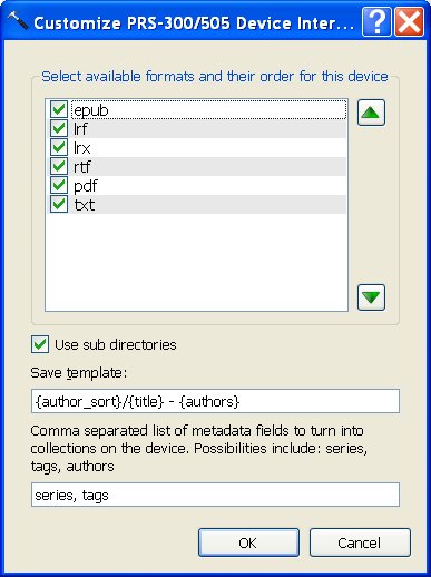

Sorry for the confusion, I meant when books are sent to your Sony device, in accordance with Calibre's default settings under device interface plugins, all tags (not surround by []) and series are turned into collections. See attached.

Use Calibre to delete all of the books that make up the series. Calibre automatically removes or adds collections based on if there are any books for that collection.
