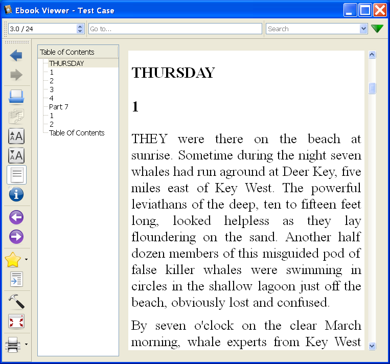

I took your Test Case text file, followed Kovid's suggestion as quoted above. To avoid confusion I attached an image of the settings I used.
Originally Posted by p3aul View Post
This is what I had in mind:
Title rendered by h1 or #
Part one as h2 or ##
Chapter one as h3 or ###
Chapter Two as h3 or ###
Chapter Three as h3 or ###
Part Two as h2 or ##
Chapter One as h3 or ###
This seemed to create the TOC structure you want. It shows the h2 and h3 items. I might be missing something, check out the attached image of the TOC.
I also attached the ePub it created. Isn't this what you asked for?
