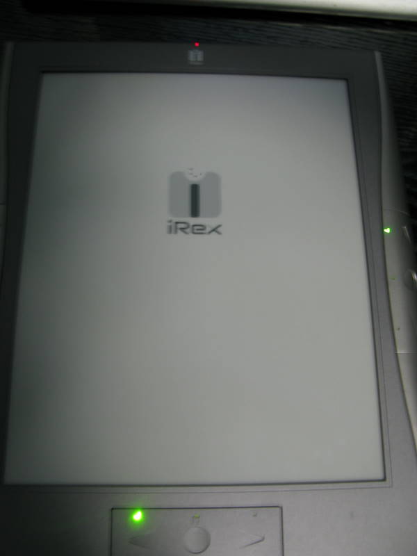

The DR1000s will not go past displaying the irex logo, the main/power LED blinks red, and in the Middle/Bottom touch sensor Strip the Right most LED is lit, while in the Right Touch Sensor strip the top most LED is lit. The main 'O' button seems unresponsive, and the unit will not turn off. The eink screen is working and the dot of the eye, just rotates round and round... (mocking me D: )
I tried to update the firmware manually through the SD card as suggested in the irex support forums, but to no avail as after displaying the "Updating" and "Update finished screen", it reboots back to the aforementioned error screen.
I am currently in contact with a support rep using their trouble ticket system. And I'll give a report on what it means hopefully when they reply.
