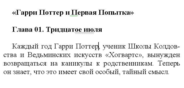

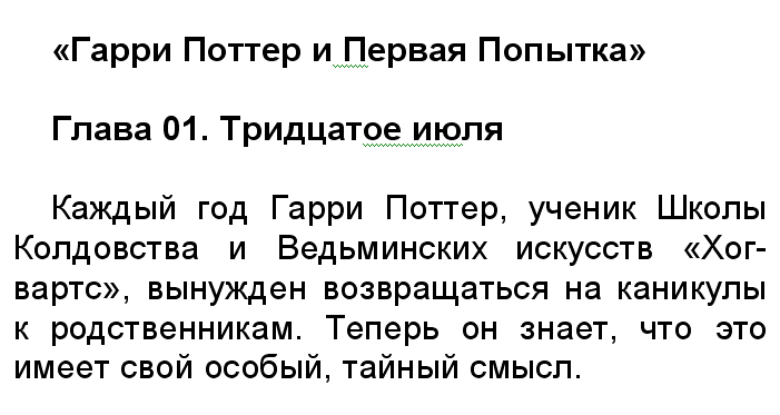

scotty1024,
I meant true text as fonts in PDF. And
I attached text in PDF and part of same text in PNG.
Upload to iLiad and feel the difference! PNG image looks more crisp, isn't it?

I created 759 x 933 image (and 158 dpi) in Photoshop then choosed PDFCreator as printer and in page properties set 122 x 150 mm.
And I've got PDF with text as image which looks crystally sharp.

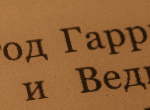

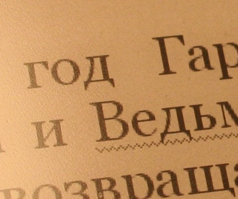

I've attached two photos of iLiad screen I did with Canon 350D camera.
iLiad PDF.jpg - text displayed in PDF file. You see that symbols has jaggies.
iLiad PNG.jpg - same .doc text opened in Word, PrintScr key and saved as PNG image. You see that symbols look clear and sharp.
