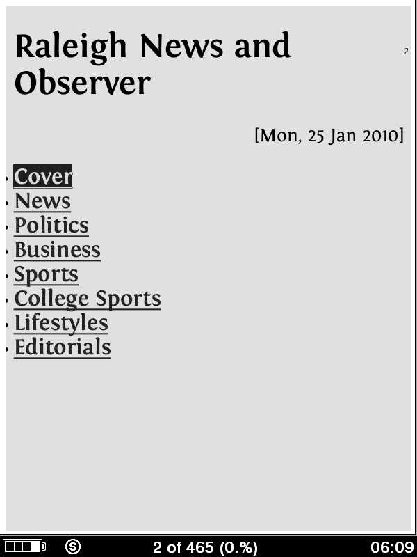

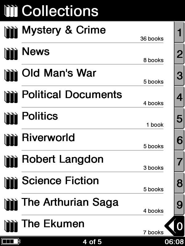

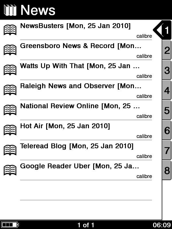

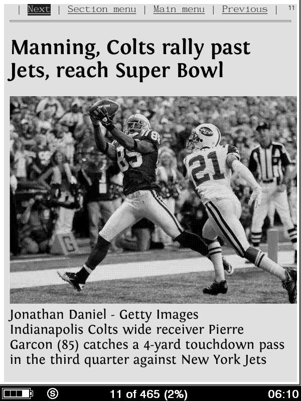

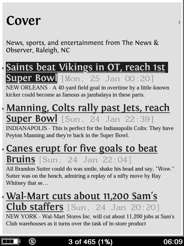

Here is some reading on creating recipes for yourself. I would suggest that you ask the smart folks in this thread how to get feeds formatted exactly the way you like.
Just to let you know how those of us outside the Kindle exist I have attached 5 pictures.
  1. My Collections page 4 of 5, My news is sent to the News collection area.
  2. What my News collection has in it.
  3. Raleigh News and Observer feeds.
  4. Selecting the Cover sends me to the beginning of the list of articles that appear on the cover of the newspaper.
  5. I select the article and end up on the first page of selected article.
Good Luck
