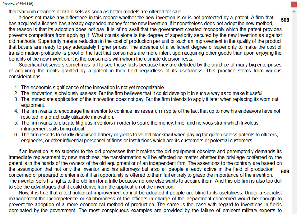

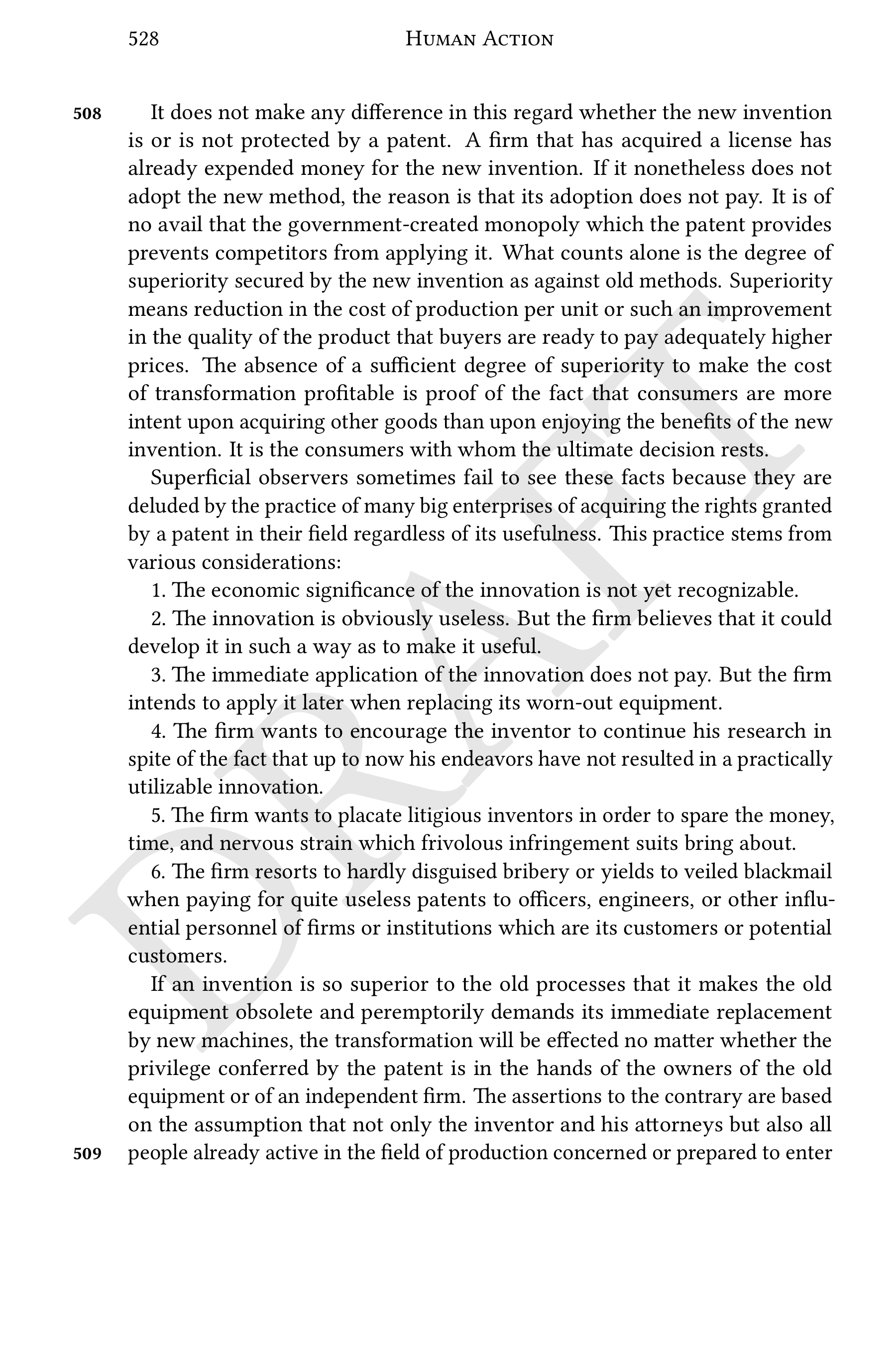

Depending on your EPUB's code, a compromise may be to visibly display the original page numbers, and float them into the margin of the PDF, similar to this:
I'm not familiar at all with Calibre's PDF output, but you should be able to finagle something using HTML+CSS and negative margins:

Here is how the EPUB appears in Sigil:
Of course, your book's exact code + PDF settings will be different, so you'll have to experiment with what negative margins work well for your book.

Yep, I know that game. The screenshot I shared above was from a book I've been retypesetting over years. It took me months to recreate the Index, and I'm still not done with it. I wrote about that experience in previous threads. (Indexes are incredibly information-dense, and thousands of cross-references can be condensed into a very small amount of space.)
