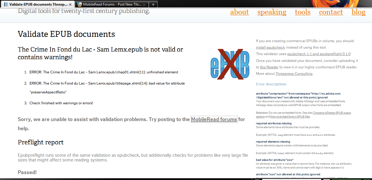

anyone here know about converting to an valid EPub file, i checked it online and it gave me errors and told me to post here and see so here i am. Any ideas guys? I have attached a screenshot of my errors. It's my first ebook.
Name:	EPub screen.png

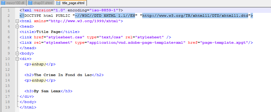

The first error is saying that, on line 11 of the file "chap01.xhtml" inside your EPUB file, there's an element which isn't properly closed. Given how early in the XHTML file that is, it's probably in the HEAD section of the file, and quite possibly one of the elements that consists of just a single tag, which should end in " />" - the most likely thing is that the closing "slash" character is missing. Alternatively, it could be an element that is missing the closing tag (e.g. for every <p> there should be a corresponding </p>).
The second error is indicating that, on line 14 of the file "titlepage.xhtml", there's an element with the attribute "PreserveAspectRatio", but the value given for that attribute is invalid. As far as I know this attribute is part of the SVG element, and the most likely value you'd want it set to is "xMidYMid meet" (see http://www.w3.org/TR/SVG/coords.html...RatioAttribute).
If that info doesn't help you fix these errors, I suggest you give a bit more info about what format you're converting to EPUB, and what tool(s) you're using, and hopefully someone will be able to advise further.

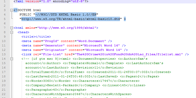

Thanks guys, im checking into flightcrew right now, just wanted to check in so you know im still here. Just started college again so im in and out. First im converting a word file to epub and im using calibre to do so. I had done some looking into this previous to making this ebub and seen about using a word doc and trying to edit out all its markups, im hoping i did that correctly. I looked at my one file, the chap01 file and from the looks of things i dont see that i have anything that is not closed. As for the other file i am still looking into it. I will post some screen shots. Thanks again.
Sam
ID:	65770   Click image for larger version

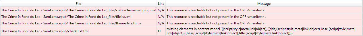

Name:	flightcrew screenshot.png

Thanks for posting that info, Sam. I think the problems you're encountering are because of how you're saving off the Word file to HTML. You want to save as "Web Page, Filtered" - that will minimise the MS-proprietary stuff that goes into the HTML file. All of those XML files (colorschememapping, themedata, filelist, etc) are MS proprietary format files - in fact I think those are files that form part of the .docx XML format. They shouldn't be forming any part of the EPUB.

Got it to work! thanks for everyones hints. One thing i had to change was that my <title></title> was empty and i guess there needs to be something in there. :P as for aspect ratio thing, there is an option on calibre under output options for aspect ration and it needs to be checked. See this: https://www.mobileread.com/forums/showthread.php?t=86293
