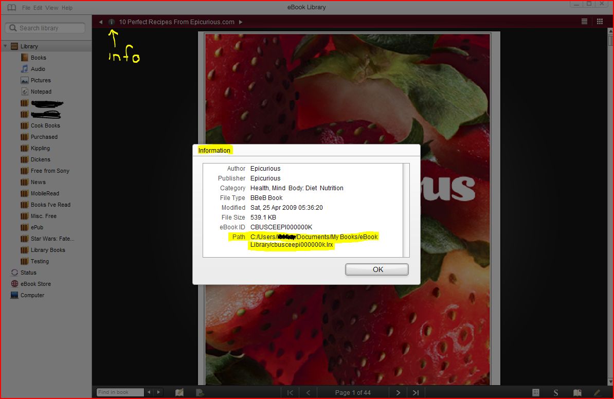

If your eBooks are viewable from the eBook Library, just open up the eBook and click on the (i)nformation icon. That should show you the path of where the eBook is located.
If the eBooks are not in that path, they won't open and you'll get an error saying that the eBook has been deleted or moved.

1. Try opening an eBook using eBook Library on your PC.
2. If you can open the eBook, click on the (i)nformation icon shown in attachment below (pointed to with the yellow arrow). An information window will pop-up that shows you the path where the physical ebook file is located.
3. If you can't open the eBook, it has been moved or deleted.
Attachment is an example using v3.0 of eBook Library. The information icon may be located elsewhere in verstion 2.5.

The info icon...Why didn't I think of that?:>}
