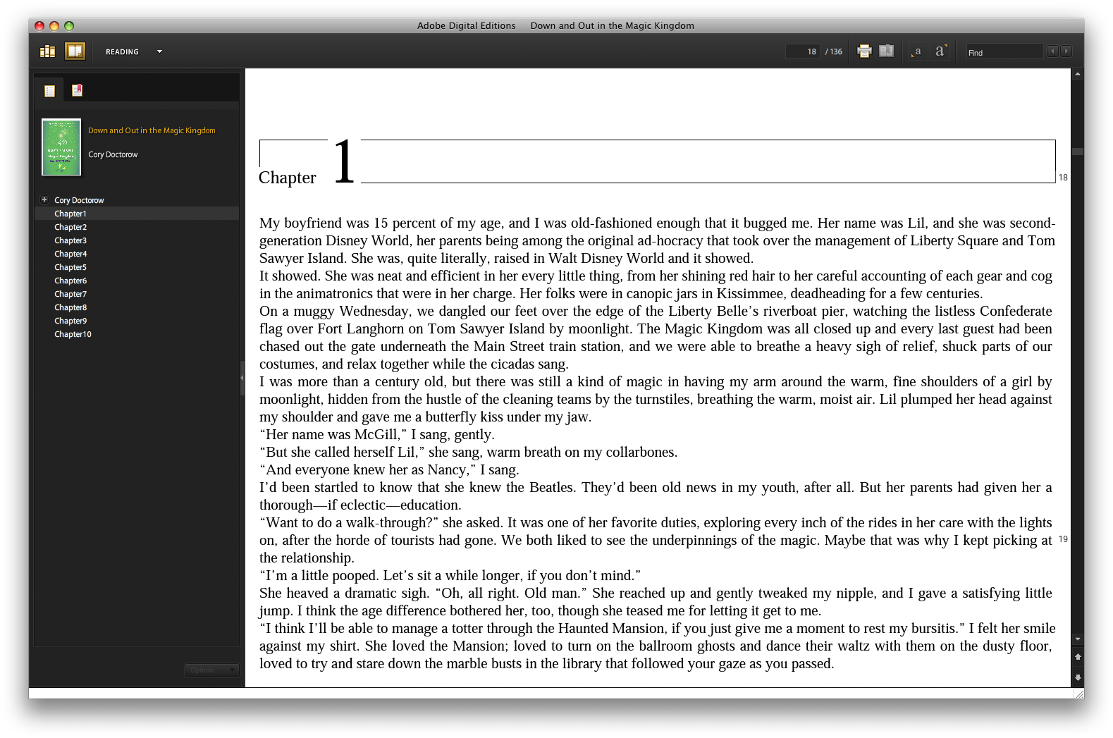

1. I download Cory Doctorow's "Down and Out in the Magic Kingdom" from Feedbooks. (I have this problem with any epub or html with indents)
2. Open in Adobe Digital Editions and indents are there (see Picture 1).

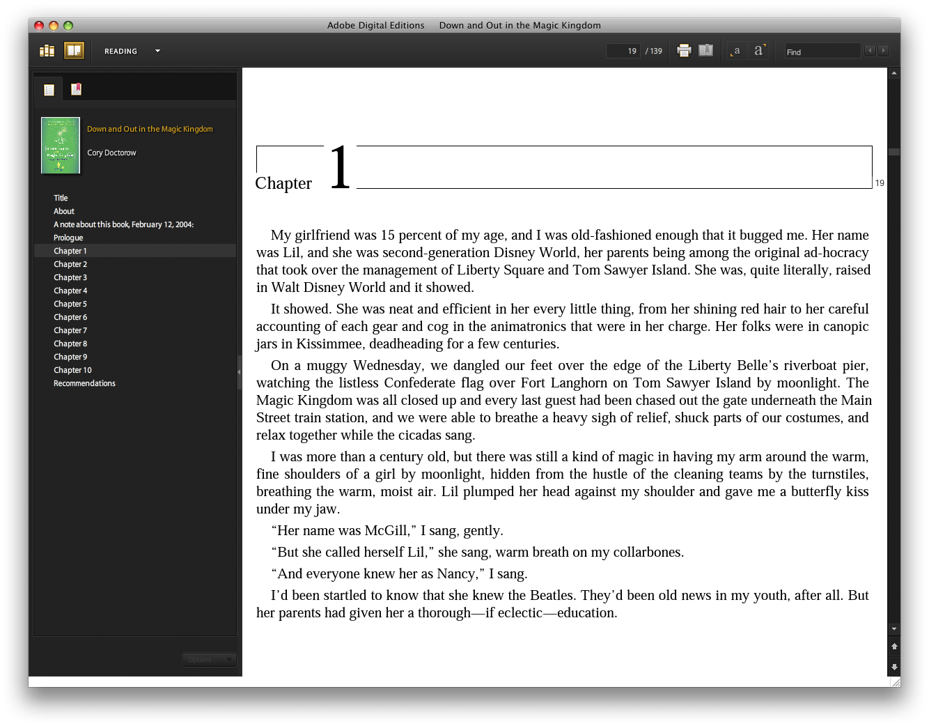

3. Open in Sigil 0.15 Mac and indents are gone (see Picture 2).

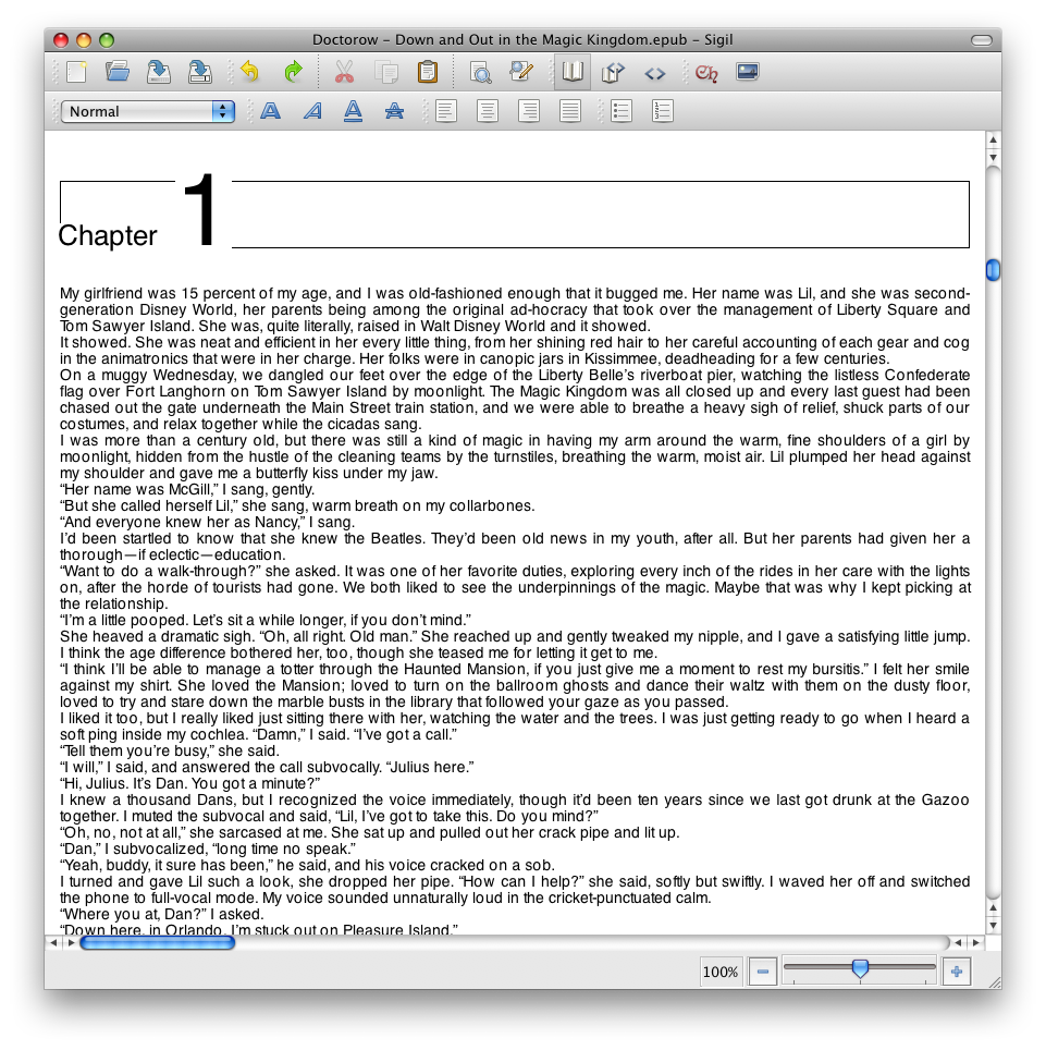

4. Make small edit (girlfriend to boyfriend) and resave as epub.
5. Open the new epub in Adobe Digital Editions and indents are gone (see Picture 3).

Found it. The book you posted uses @import CSS rules to import external stylesheets. That doesn't currently work in Sigil. This will have to wait until v0.2.0 (I'm starting to sound like a broken record...).
An easy workaround is to just copy the CSS directly and not use the @import rule.
