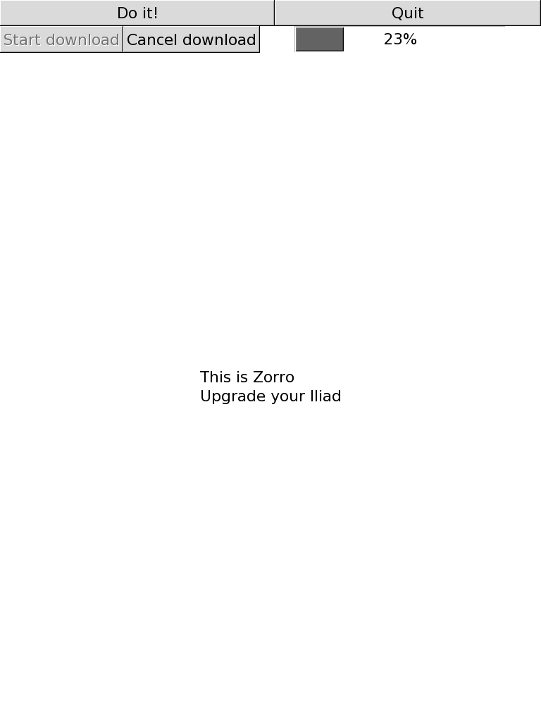

Proof of concept...
Here's a proof of concept: a full screen gtk app that downloads a file while showing it's progress. Written in Lua...
The attached file includes the application script, ipk's for Lua, an xepdmgr like program for display refresh, and a nice installer.
Have a look and let me know what you think...
