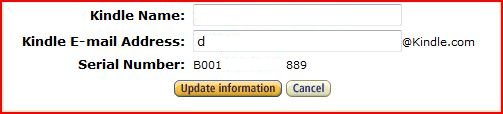

Should still work as the SN follows the same format as Kindle 1. I'm too lazy to try it now but I will try it and post my results.
B001 = Kindle 1
B002 = Kindle 2

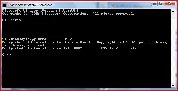

KindlePID did generate the correct type of PID.
