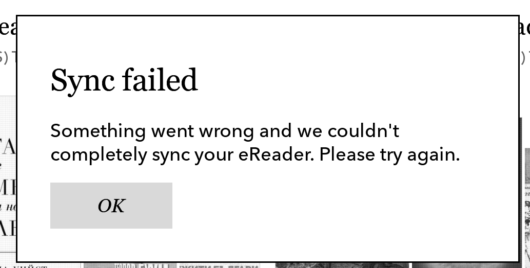

Hello! Does anyone have this synchronization problem? I thought I did something wrong when patching, but it turned out that it's the same with the original firmware.
P.S. My mistake. I forgot that I changed my password months ago
