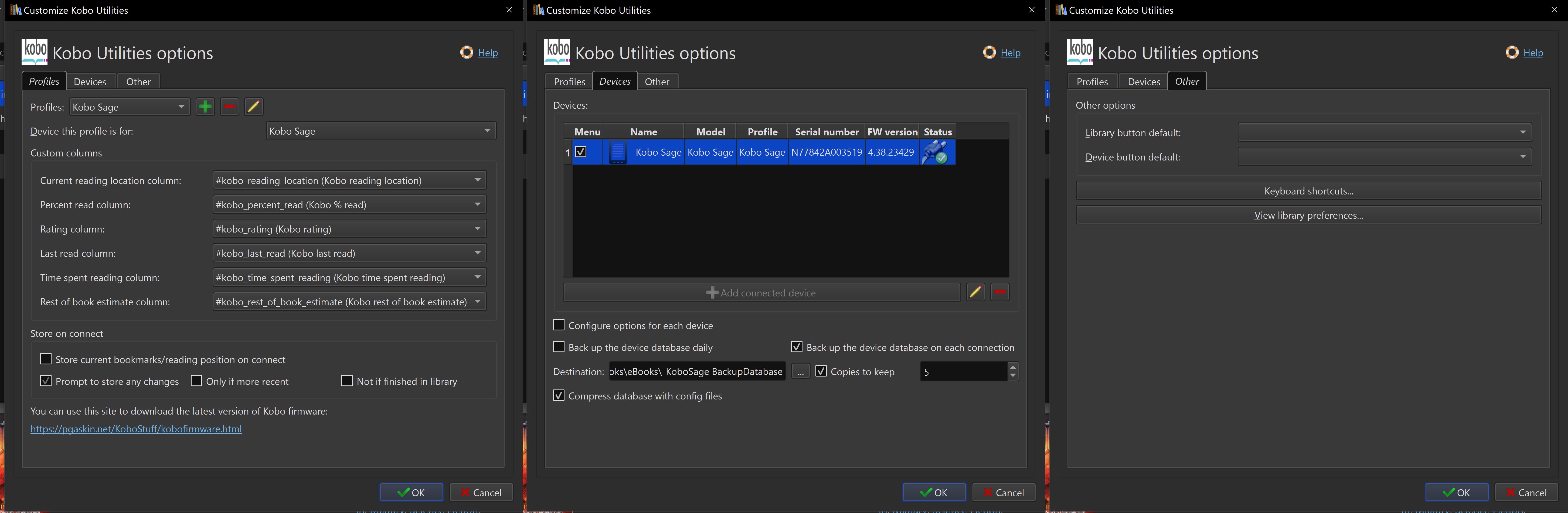

Hi.. I just bought a Kobo Sage and having a hell of a time trying to get it to work with Calibre.
what is happening
Basically it sees the device and has the "send to device button"... I can click it and it will "send", show the tick and eveything... but when I unplug the Sage from my computer there are no new books visible on the device. If I then plug the device back into the computer and open Calibre again, none of the books i just sent have the "green, on device" tick anymore. If I browse to the root of the dir accessible via windows explore, all the books I uploaded are there in the root.
What I have tried
I found this guide Calibre setup for Kobo ebook reader posted 12 July 2025 on a blog called "juliusunscripted".
It told me to install a plugin called "Kobo Utilities". I did this and then followed the other instructions in the post. The only thing I did different is that in Kobo Utilities I made a profile for the device, and added the "new columns" by clicking create columns and then using the default values.
<edit> Remove link to imgpur and added image as attachment DNSB
The only settings I didn't change was in the OTHER tab, as I didn't know what they were or how to use them.
After following that Blog
The blog just runs me through some steps and then says to click the "send to device button". After it is sent I can click on "device" and see the books. I try to be super careful, so I exit Calibre, then in explore right click on the kobo and select "eject" before unplugging it.
Last edited by DNSB; 10-20-2025 at 07:43 PM. Reason: Removed image link and added as an attachment
