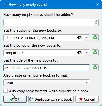

I did it using the following steps:
  • Create an empty book with an EPUB format. I set the title, authors, and series correctly

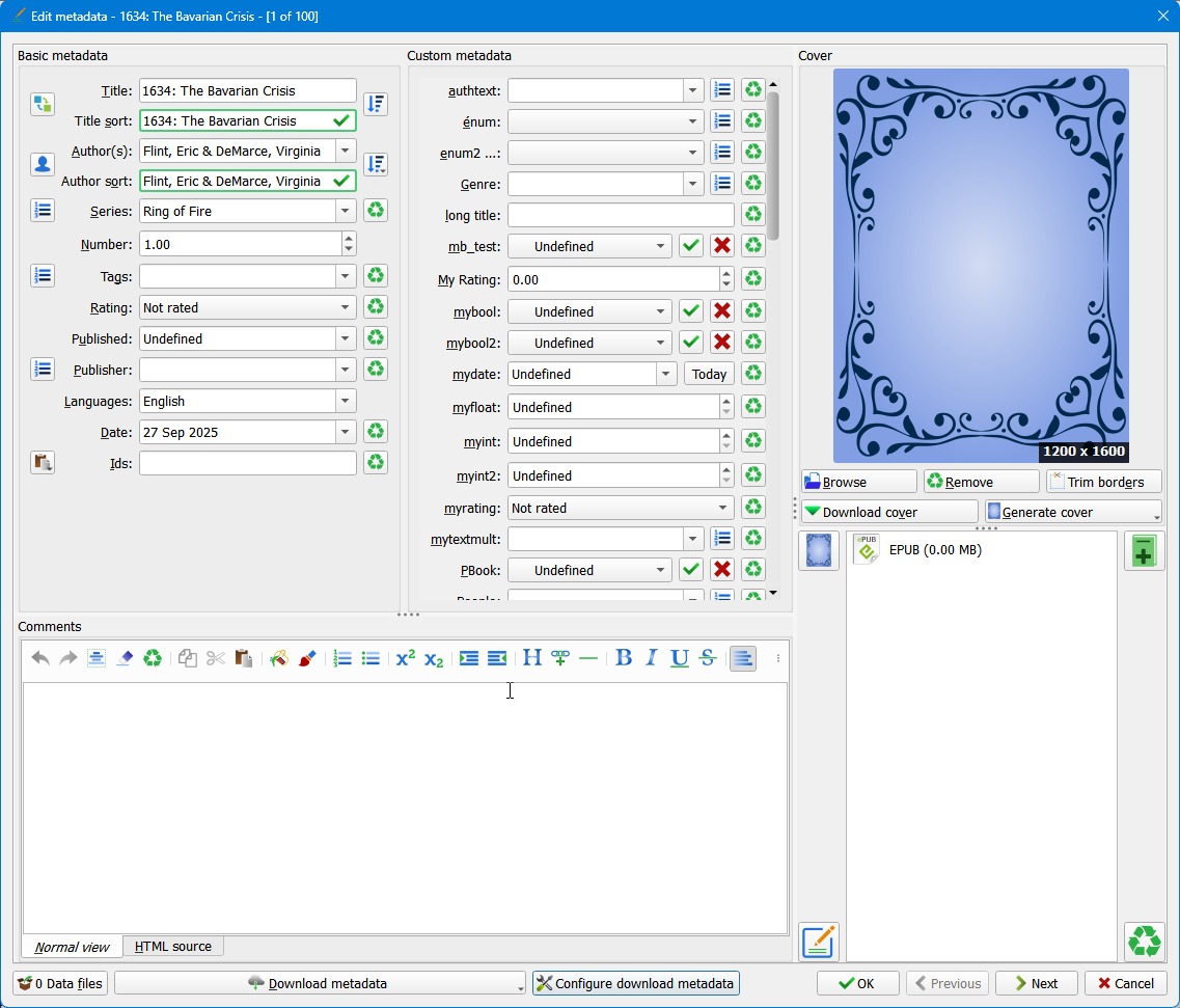

  • Edit metadata to set tags and a cover.
    Before download metadata I see the following, no cover, no tags, no comments.

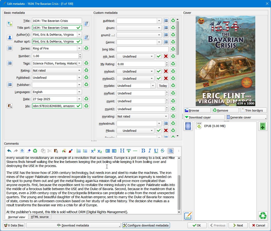

    After download metadata I see

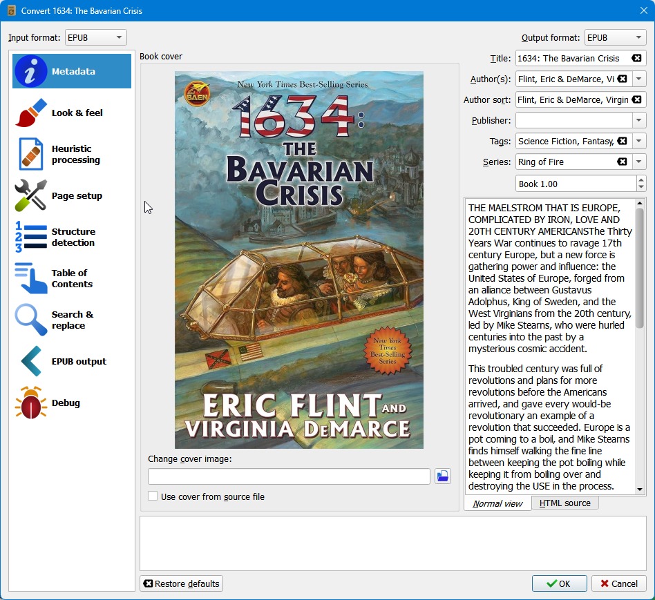

  • Do and EPUB-to-EPUB conversion, which embeds the metadata and cover.

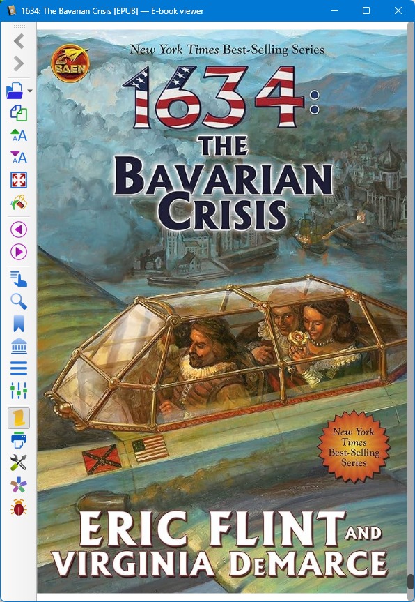

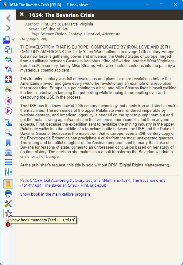

  • Use calibre's viewer to look at the book. I see the cover.
  • Use calibre's viewer to look at the book's metadata.

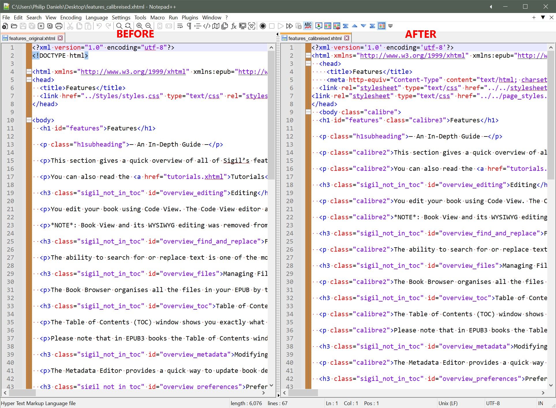

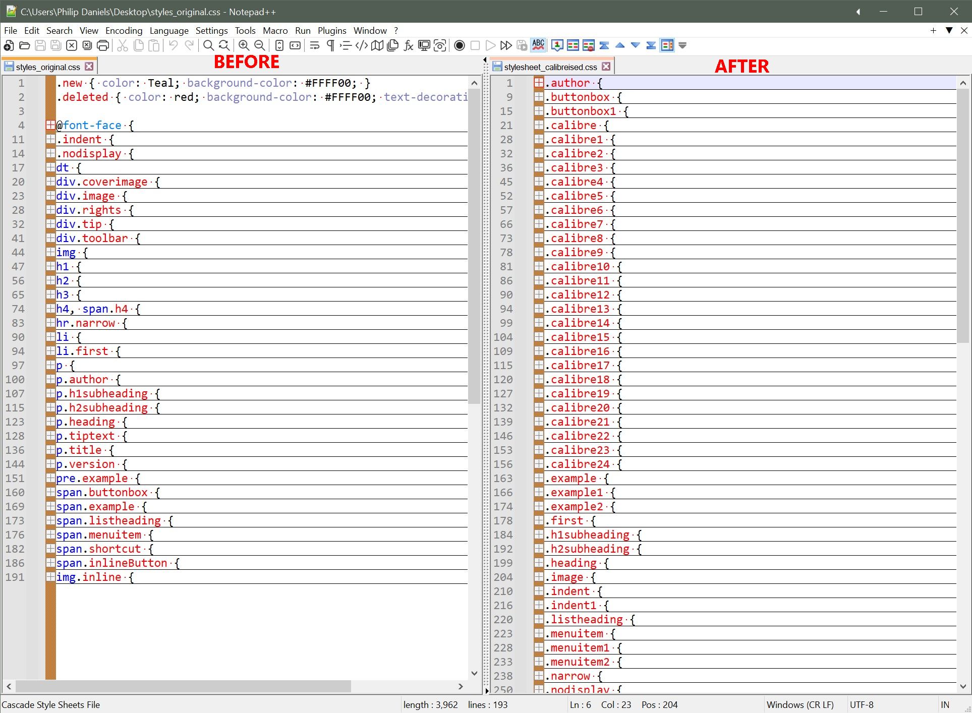

EPUB→EPUB conversion changes the style sheets and the text files:
ID:	218321 Click image for larger version
If you only check Update metadata in the book files in Polish books it will only change the .opf file.
