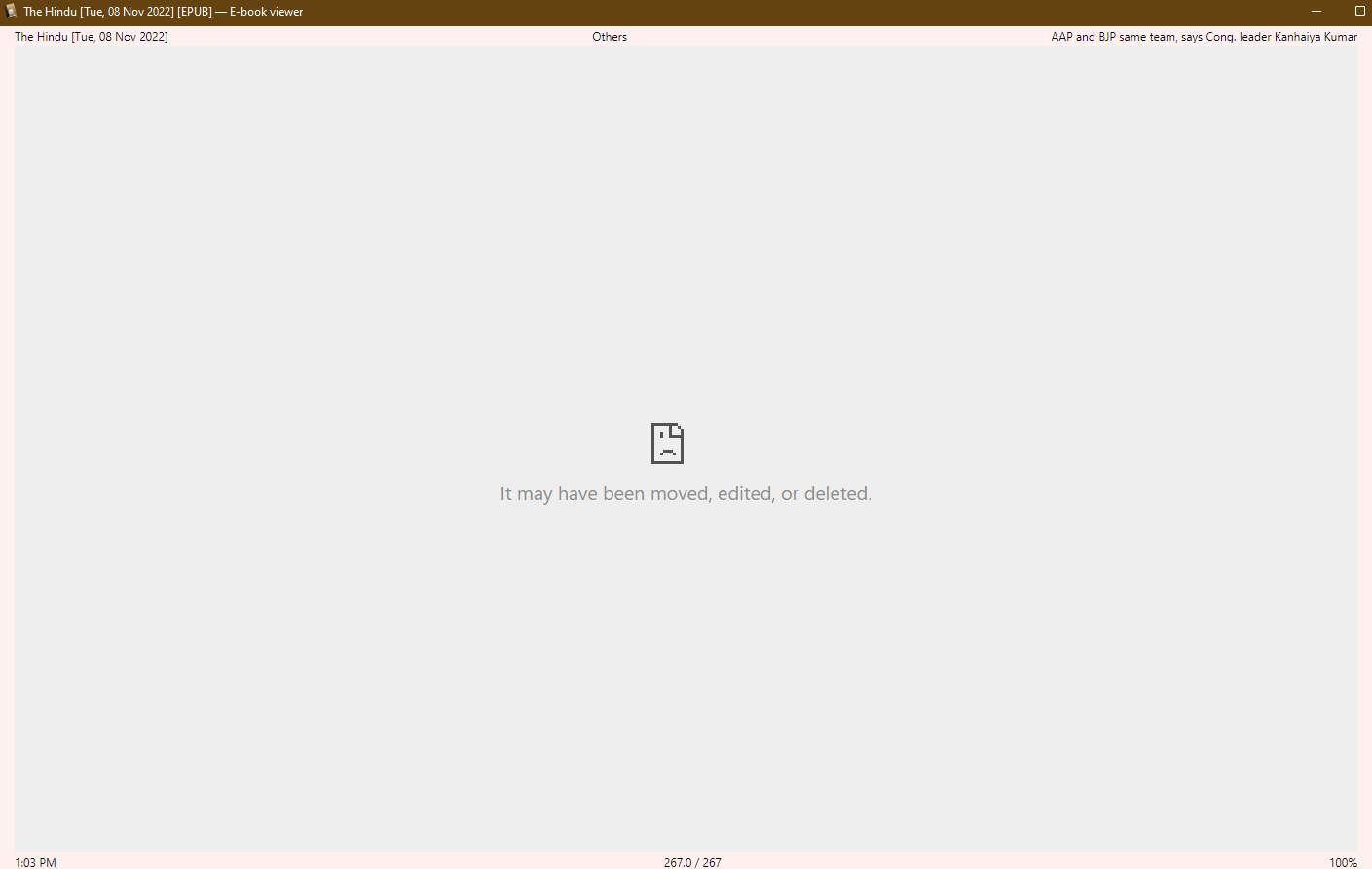

I keep getting these errors (screenshots attached) when moving on to the next article/chapter in the fetched news epub, viewer gets stuck here & I'd have to close the viewer and reopen file.
"it may have been moved, edited or deleted" error happens a lot.

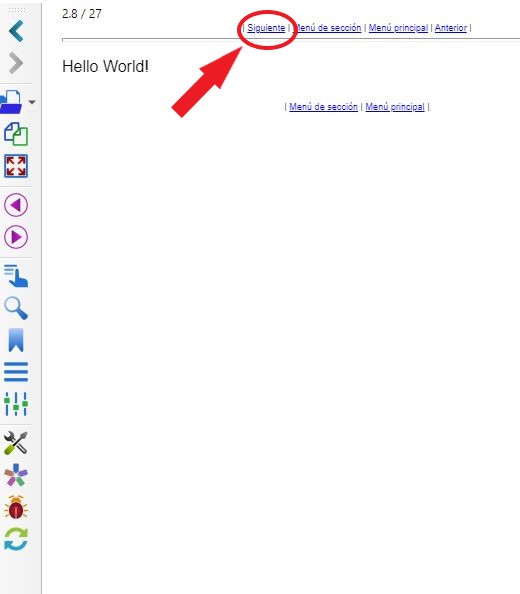

I should clarify that there is not problem when navigating using the scroll bar.
The problem appears when clicking in "Next" button in top navigation bar.

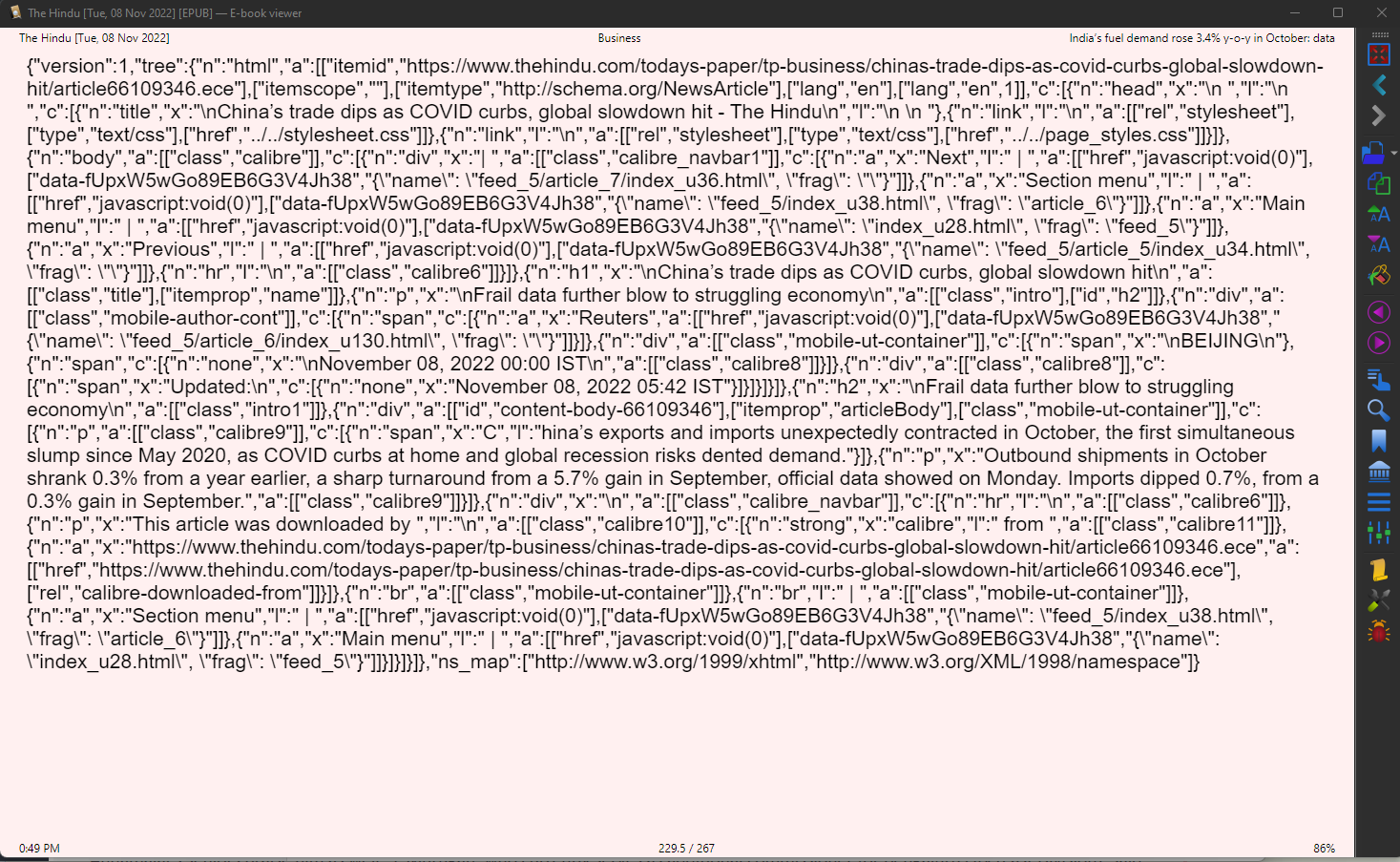

Tried clicking on Siguiente and got a screenful of code at random intervals. I've attached an image of the screen.
