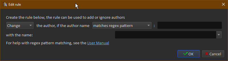

I want to change it in the author mapper. I can make a regex to match it. I don't know what to put in replace.

Without trying it, I think the search should be
([a-zA-Z]\.) ([a-zA-Z])
replace would be
\1\2
Old 06-09-2025, 12:25 PM   #8

Tried it. Worked! Also better regex than the one I came up with.
