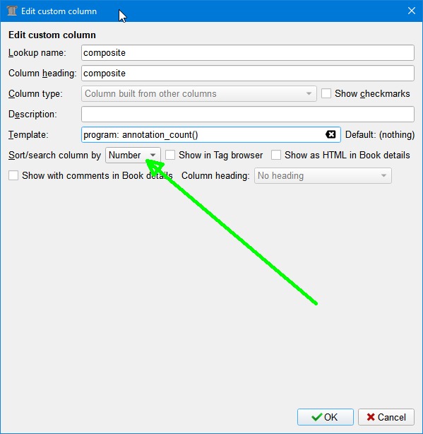

After using more and more annotation, I like to sort them by number.
But it seems the value is a string and therefore sorting is 1, 11, 2, 20, ...
I use a column with template program: annotation_count().
How can I change that to get the value as a number for proper number-sorting?
Change the search/sort type for the column to "Number".

Old 05-25-2023, 07:20 AM   #7
Katja_hbg
Katja_hbg can program the VCR without an owner's manual.Katja_hbg can program the VCR without an owner's manual.Katja_hbg can program the VCR without an owner's manual.Katja_hbg can program the VCR without an owner's manual.Katja_hbg can program the VCR without an owner's manual.Katja_hbg can program the VCR without an owner's manual.Katja_hbg can program the VCR without an owner's manual.Katja_hbg can program the VCR without an owner's manual.Katja_hbg can program the VCR without an owner's manual.Katja_hbg can program the VCR without an owner's manual.Katja_hbg can program the VCR without an owner's manual.
Posts: 189
Karma: 197760
Join Date: Oct 2015
Device: Kobo Glo HD (landscape), Kobo Aura One
Thanks Chaley.
I missed that.
