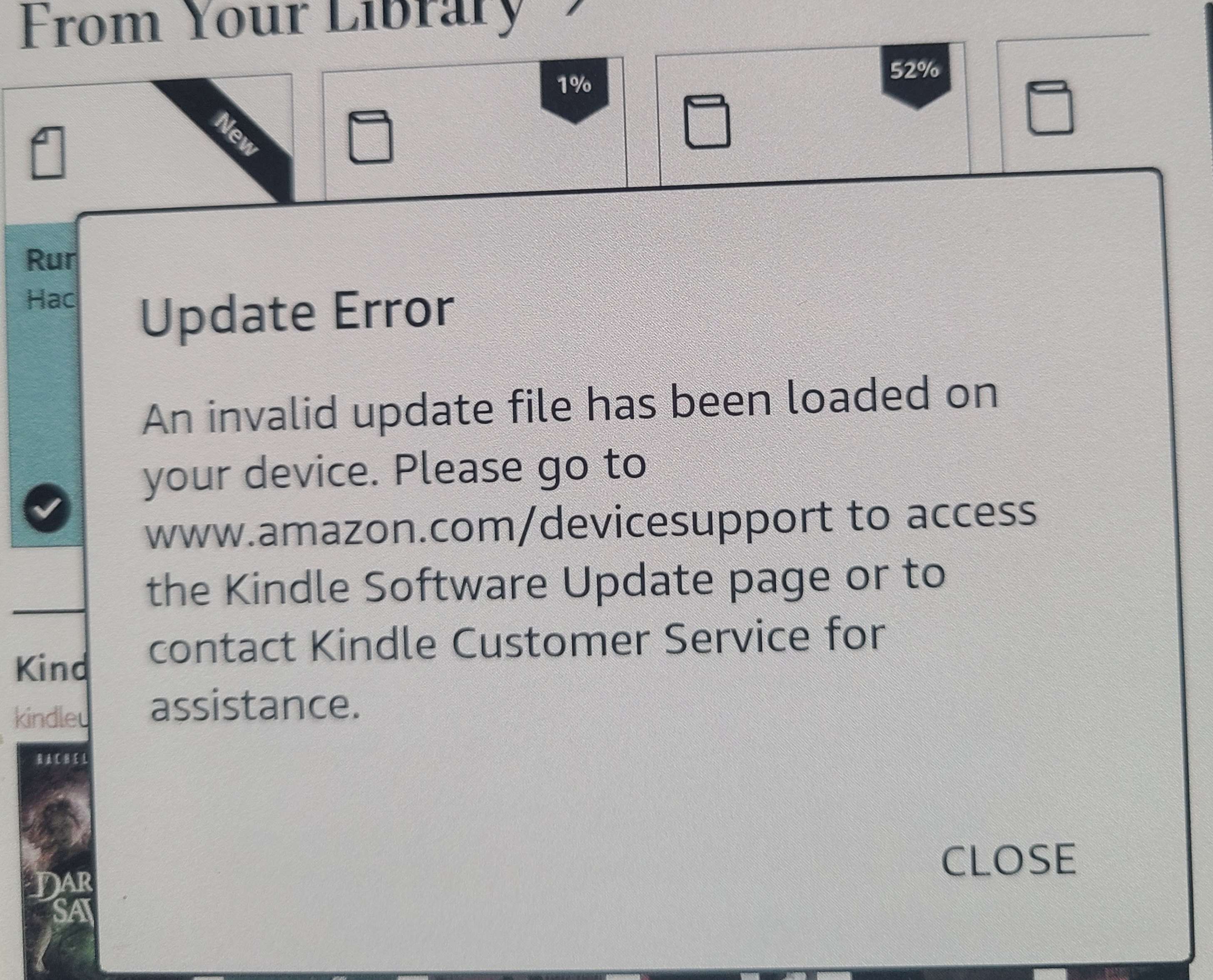

Hi, I am trying to install KUAL on my Colorsoft but am having no luck. When I run ;log mrpi I get a white screen and then after a bit it goes back to home page but no KUAL.
I tried the hotfix via update method but no luck

That screen suggests that your Colorsoft has not been jailbroken.

I redid the jailbreak, same results

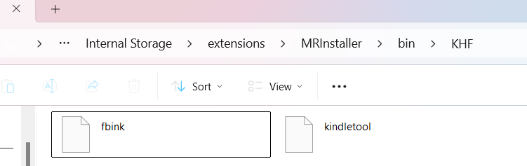

If yes, and mrpi still doesn’t work:
Does the folder storage/extensions/MRInstaller/bin/KHF/ contain two files? fbink and kindletool
If not, then that means your unpacking software messed up, try another software to unpack the MRPI archive

Im not sure I got the hotfix to properly install, but I just checked and I see the 2 files you mentioned
