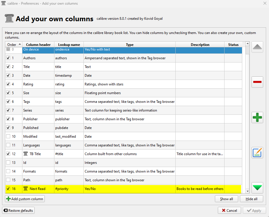

So, I added a custom column. I gave it a Lookup Name, Column Heading, and Description.
I set Column Type to Yes/No and told it to show an Icon (Default Value is blank).
I see it selected in my custom columns, but I don't see it anywhere in my interface. Where do I set the value on a book and see it in the list of tags in my sidebar (Author, Languages, Formats, etc.)?

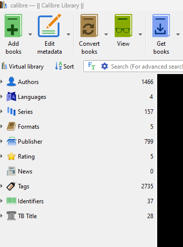

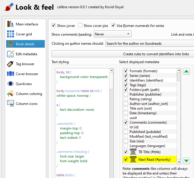

Firstly, you need to check it in the Add your own columns list (check boxes on left), and in the Look & feel->Book details list.
Yes/No columns are not shown in the Tag Browser.
This part is set. I think it automatically checked it when I created it.

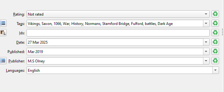

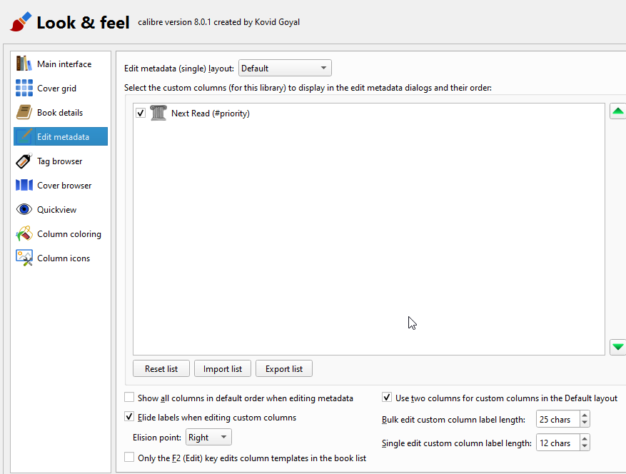

The first couple of images are what my settings look like after adding the new column. The next couple show that I don't see my new field in either the main window or on the metadata for a book. However, I also came across something else that shows my new column, but I don't know what it is.

Suggest you change Look & feel->Edit metadata->Edit metadata (single) layout: to All on one Tab -- it's at the top, above the list. And try Compact too.

By default, custom columns are displayed in a separate tab of the Edit Metadata window. You can change this by selecting the "all in one tab" option for the Edit Metadata layout.
That change did it! Now I can edit the status to put something as a priority for my next read. I've also been able to create a Virtual Library of the same using that search criteria. Now I should be able to do the same for marking something as Read.
